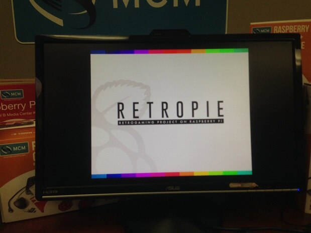

3. Booting up the Emulator
- Insert the micro SD Card into the PI and connect your mouse, keyboard, network cord, monitor and power supply (also game controller if you have one)
- The Pi will now boot up and into RetroPie

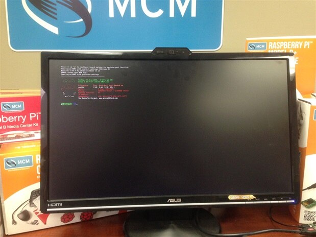

- Press f4 which will take you to command line
- Type sudo raspi-config
- Select Expand File system and accept until you’re back to the main screen
- Go to Advanced Options->SSH and enable it (Mine was already enabled)
- Go to overclock, select Medium
- Finally, select finish and then select yes to reboot

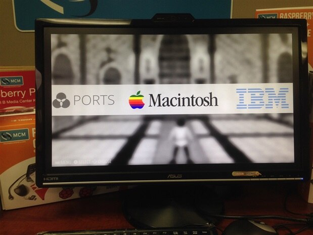

- Once you restart you will be taken to the main screen which will show your loaded emulators
