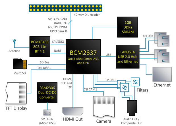

This is just a High Level Diagram approximation of what the Pi 3 consists of.
It is based on various bits of information on the Internet, and could be incorrect in places.
If you have any corrections, or additional bits of information/suggested tweaks, please let me know and I'll get the diagram updated.
Thanks!
Diagram revision: 4

    rev. 4!.... ...nice... The next step what i thought are exploded block diagrams around the components with its details. This details may coming up by clicking on that. Details: e.g. called address and…
    balearicdynamics over 9 years ago +2
    Well done job. It is always a mess to search here and there to design a global scenario. Maybe it is not complete but sure it is very useful at least to know what to expect and some parts are well detailed…
    DAB over 9 years ago +2
    Nice, I can always find interesting information in a diagram like this. The board architecture can tell you a lot about the system's capability. DAB
    Details: e.g. called address and space, small description of the properties, ...
    Gerald
    shabaz over 9 years ago in reply to balearicdynamics
    Good idea. Perfect, it has been updated, to rev. 4!
    balearicdynamics over 9 years ago in reply to shabaz
    For completeness, maybe PWM too image I am thinking to a certain interesting discussion few days ago ...
    Enrico
    Aah, you mean I2C and I2S is missing? : )
    I'm glad you found this, I will correct it straight away : )
