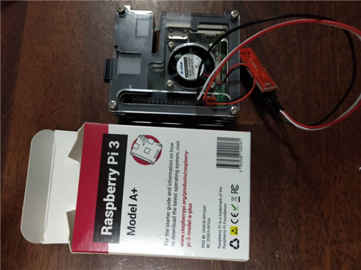

Just less than 2 weeks go i did my first try on Raspberry Pi 3A+
I put down these items as part of my experience dealing with it
1) Casing with fan
i put my raspi 3A+ into this 9 layers acrylic casing with fan. one can reduce the layers to suit his need. For me i remove 1 layer so that it is easier to
put in my pioneer600 HAT

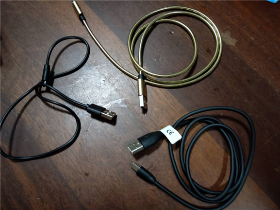

2) USB cable
i have read that the raspi 3A+ need decent power 2A but  i still face problem powering it up. When it doesn't have enough power, it won't boot.
I need to connect to a screen in order to realize this problem. In fact i wasted like a day
to fully narrow down to the root cause --> the USB cable. Although i haven't  known the cable spec, but apparently there
are some USB cables that cannot carry sufficient current. Interestingly, it is not determined by the cable diameter.
in the picture below, the thickest cable of the lower right hand side, in fact, is the culprit that cause raspberry pi failure

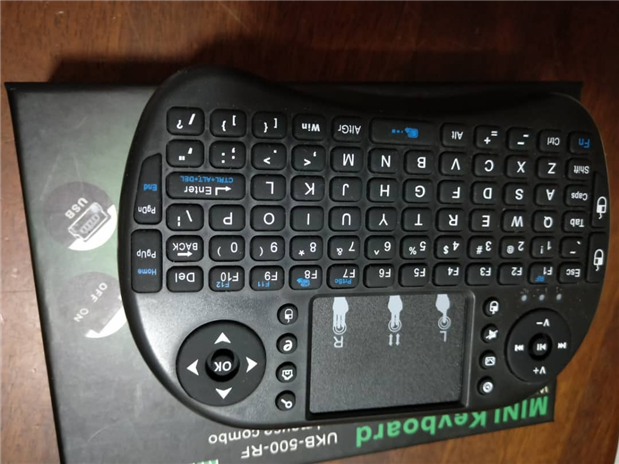

3) usb keyboard
this mini keyboard with mouse, albeit not very easy to type, does bring a lot of benefit to troubleshooting the raspi
i have faced tremendous problem in the wifi stability, and i have used this keyboard a lot (along with monitor) to view and troubleshoot the network
4) the FTDI USB to UART
i use this module ( you can see it in photo in (1) to send data over serial port for troubleshooting, just like how we use serial monitor with Arduino

    weiwei2 over 6 years ago in reply to clem57 +2
    yes, actually till now i don't really know how to know whether the power is sufficient. looks like going forward need to over-engineer the power requirement in my situation, i am able to run it with the…
    genebren over 6 years ago in reply to weiwei2 +2
    I have been using ANKER USB cables for all my high power needs. They feature 24AWG power lines (30AWG signal lines) and these cables have performed flawlessly with currents in the 2-4 Amp range. Plus they…
    dougw over 6 years ago +1
    Getting enough voltage and current to the RPi seems to be a common issue that isn't well documented. I mean, although many people describe problems, there isn't much data indicating exactly what voltage…
    I have been using ANKER USB cables for all my high power needs.  They feature 24AWG power lines (30AWG signal lines) and these cables have performed flawlessly with currents in the 2-4 Amp range.  Plus they don't break the bank (3 pack 3ft for $10.99 on Amazon).
    dougw over 6 years ago in reply to weiwei2
    I use 18AWG USB cables when I need to be sure of low losses in the cable. There are very few suppliers and they aren't low cost.
  • weiwei2
    in my situation, i am able to run it with the same cable and extension plug in my office, but when i reach the demo setup venue, it can't run. The only reason i can think of is the network connectivity (wifi) at the demo event is much weaker and my pi does have lots of network problem. However, this doesn't explain the reason that it can't even boot, until i change to a good cable.
    now i start to appreciate all those fancy higher priced data+cable that is sold in local handphone accessories shop, that claims better current carrying capacity and data speed (presumably due to shielded construction
  • clem57
    clem57 over 6 years ago in reply to dougw
    The reason for little doc is due to USB power requirements that may vary greatly...
    Getting enough voltage and current to the RPi seems to be a common issue that isn't well documented. I mean, although many people describe problems, there isn't much data indicating exactly what voltage and current work and what doesn't work and what the power supply transient performance needs to be.
