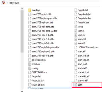

Enable SSH Support via Wifi
1. Open the boot directory on the SD card you just imaged
2.Create a empty file named SSH in the boot directory of the SD Card
               .image
3.Make sure to remove any extension on this file, for instance in my case, I created the SSH file by creating a TXT file named SSH, I then enabled viewing extensions and removed it from the file. To enable viewing extension, follow this guide

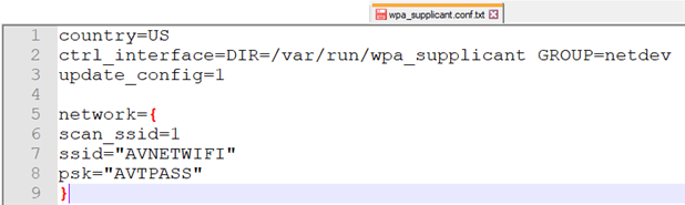

4. Create a new file named wpa_supplicant.conf and add the following text into the file. Please note where is says your_wifi_ssid and your_wifi_password you must put your wifi SSID and Password                   --->imageimage
country=US
ctrl_interface=DIR=/var/run/wpa_supplicant GROUP=netdev
update_config=1
network={
scan_ssid=1
ssid="your_wifi_ssid"
psk="your_wifi_password"
   5. Similiary to the SSH file, make sure to remove the .txt extension from the end of the file.

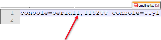

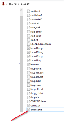

Retarget the Default Uart
1. For the Raspberry Pi 4 B, the default UART (serial0) used by console for communicating with the SBC is the primary UART which is the same UART interface the Monarch Go Pi Hat needs to use. We will need to change our console UART from primary UART to secondary UART (serial1). Open the boot directory on the SD Card in the windows explorer. Open the cmdline.txt file using a text editor, change console=serial0 to console=serial1
See completed change in image below for reference. Make sure to save and exit the text editor

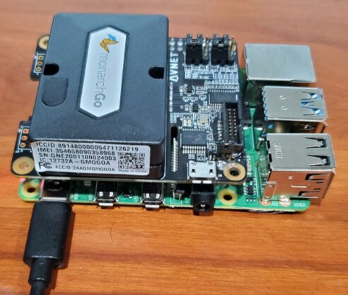

Hardware Setup

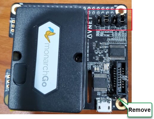

1. Set the Monarch Go Pi Hat Jumpers to Single Board Computer Operation
      • J6 : 1-3 / 2-4
      • J7 : 1-3 / 2-4
      • J10 : No Connect
2. Connect the Monarch Go Pi Hat to your SBC 40 pin GPIO Raspberry Pi Hat
3. Insert the microSD Card into the Raspberry Pi 4 B and connect the power supply. The SBC should power on.

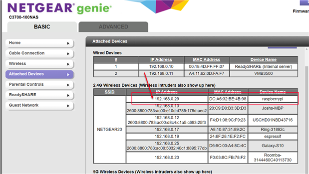

1. Now that the board has powered on, you should have enabled SSH and automatically connect the board to your wireless network

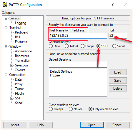

2. Now the fun part of determing the IP address of your Raspberry Pi 4 B!
3. In my case I logged into my router and determined the IP address of the Raspberry Pi 4 B
4. You can refer to your router which should have information in regards to how to login to your router. Or do a quick google search on how to login to your router! If you can't find your raspberry pi IP address when you logged into the modem, you most likely left the extensions on your wapsupplicant.conf file on the sd card.
5. Now that we have determined the Raspberry Pi IP address in my case (192.168.0.29). Open a terminal in my case putty and type in the IP address, make sure the port is 22 and SSH is selected. Then select open to start your session.
7. You have successfully connected to the Raspberry Pi 4 B

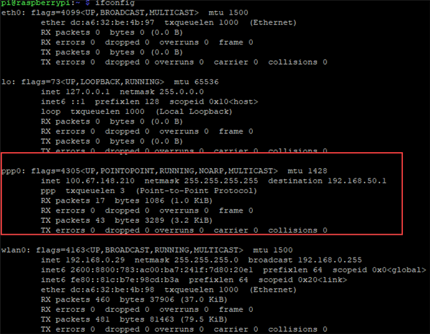

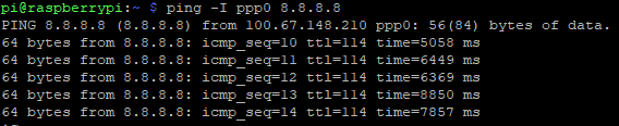

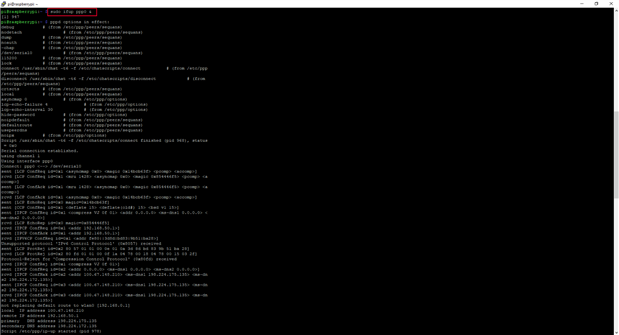

2. Now lets bring up the PPP. Run the following command
sudo ifup ppp0 &
With a bit of luck, the connection session will be negotiated successfully, an IP address assigned, and DNS servers identified:
3. Type in ifconfig and you can see the IP address associated with the Modem.
4. Congrats, you have successful brough up the PPP interface with the Monarch Go Modem. Lets now ping an interface to verify connectivity
ping -I ppp0 8.8.8.8

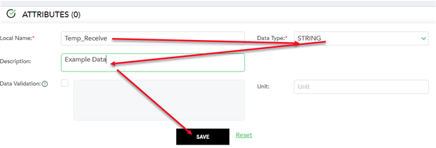

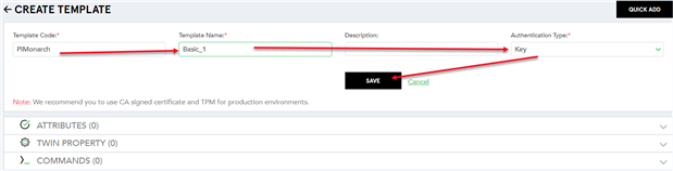

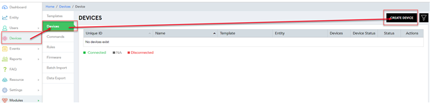

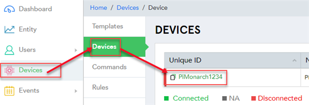

IoTConnect Cloud Solution Demo

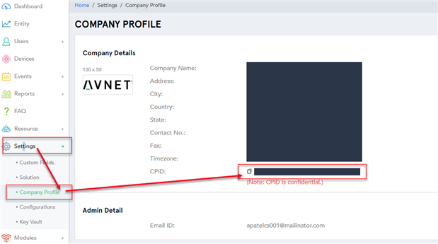

IoT Connect Account Setup
1. Sign up for Avnet IoT Connect by filling out the getting started section at the bottom this this webpage

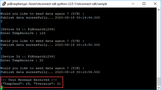

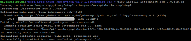

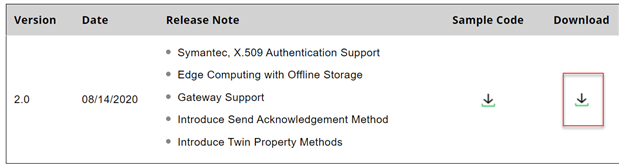

IoT Connect Python SDK Install
The folks in the Avnet IoTConnect team pointed me to the easy to use IoTConnect SDK Python client for the device side programming.  After configuring a few variables to match the IoTConnect account details I was assigned, I had some test data posting from my Ultra96-V2 board pretty quickly.
1. First download the IoT Connect SDK for Python from the IoT Connect website. Unzip the SDK onto the boot directory of your SD Card
2. Unzip the "iotconnect-sdk-pyth to the boot directory of your Raspberry Pi SD Card.
3. Eject the SD Card and plug it back into the Raspberry Pi, power up and login to the terminal
4.Go into the IoTConnect folder and use pip3 to install the iotconnect SDK
cd /boot/iotconnect-sdk-python-v2.0-1/iotconnect-sdk
pip3 install iotconnect-sdk-2.0.tar.gz
Note - The pip3 install will take a couple minutes. The Python SDK is successfully installed.

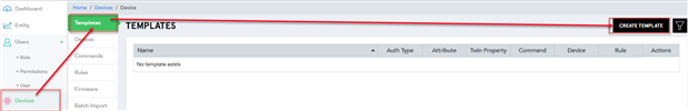

1. Create a Template in the IoTConnect Dashboard. Devices -> Templates -> Create Template
2. Save Template after filling in information
3. Create Attributes Example and Save

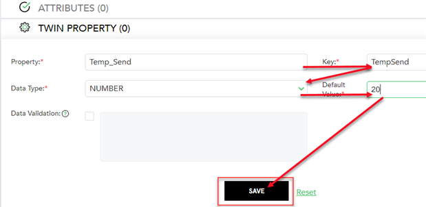

4.Create Twin Property and Save

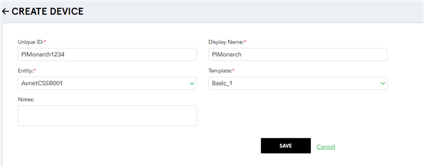

5. In the IotConnect Dashboard go Devices -> Devices -> Create Device
6. Make the Unique ID and Display name unique for to you. Select your entity and select the Basic_1 template. Select save
You have successfull setup your dashboard.

1. Return back to the "Connect to the Internet" Section we went through earlier and establish the PPP with the Monarch go.
2. Go into the sample directory and see what files are there.
cd ./sample/
ls
3. You will notice a example_py2.py example and example_py3.py example. The py2 is related to using python2, the py3 is related to using python3. Seeing as we used pip3 and not pip to install the IoTConnect python SDK, we will be using the python3 example.
4. We need to setup ppp0 as the default network run the following to determine the IP address of ppp0
netstat -rn
6. Now that we have determined the IP address, run the following substituting your own IP address
sudo route add default gw XXX.XXX.XX.X
netstat -rn
7. Run the example_py3.py example using python 3
python3  ./example_py3.py
8. You will be promoted for your device serial number (Unique ID) along with your CPID
a. The device serial number is the Unique ID we gave it when we setup the dashboard. In this example mine is PiMonarch1234
b. CPID can be found by going Settings -> Company Profile -> CPID

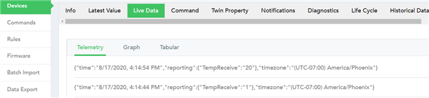

9. After about 30-50 seconds the connection will be established and it will ask for a value to send up the the IoTconnect dashboard. Before we send data lets open the dashboard up
a. Go Devices -> Devices -> Unique ID
b.Select live data, here is where you can see all the published data.
10.Type in a value to be published, you shouls see some data published similiarly to this.

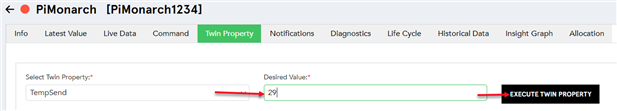

11. Now lets send data down from the cloud to the edge device. Open up twin properties at the top of the page, select the twin property we made earlier and enter a desired value to send down to the Raspberry Pi. Select Execute Twin Property.
12. You have successfuly send and received data from your clous and edge device using the Monarch Go Pi Hat.
