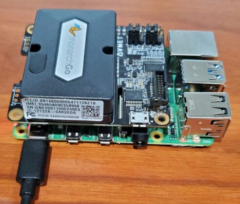

The Monarch Go Pi HAT is a cellular connectivity add-on card for SBC boards that have a Raspberry Pi HAT-compatible connector. Fitted with Sequans Monarch Go (or Monarch Go GPS) LTE Cat-M1 modem, this HAT board also facilitates expansion via Click boards using a compact onboard Click Shuttle connector. Noteworthy is that an integrated onboard USB-UART bridge interface allows this LTE HAT to also be used with other platforms.

  • Monarch Go Pi Hat
  • Raspberry Pi 4 B
  • 16GB MicroSD Card
  • USB Type C Power Supply

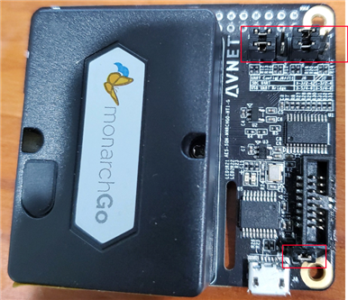

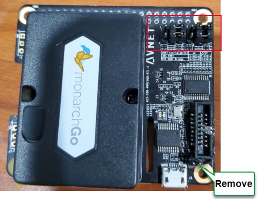

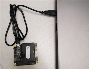

     Demo 1. Monarch GO Pi Hat Standalone Operation     The Monarch Go Pi hat can be operated in standalone operation via the MicroUSB interface
           Hardware Setup
               1. Set the Moanrch Go Pi Hat Jumpers to Standalone operation
    • J6 : 3-5 / 4-6
    • J7 : 3-5 / 4-6
    • J10 : 1-2
               2. Connect the Monarch Go Pi using the microUSB J8 connector on the Monarch Go Pi Hat to your PC using a microUSB cable

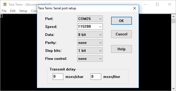

               1. Now that the hardware is all setup, open a terminal such as Tera Term or Putty and connect to the Monarch Go UART interface.
                  Please note your COM port will vary from the image below. If you cannot connect to the UART interface please verify the jumpers are configured correctly.

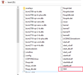

         Enable SSH Support via Wifi

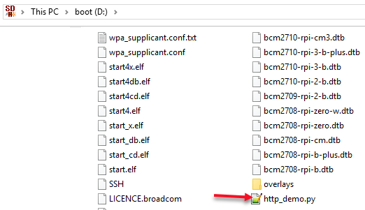

               1. Open the boot directory on the SD card you just imaged
               2.Create a empty file named SSH in the boot directory of the SD Card
               .image
               3.Make sure to remove any extension on this file, for instance in my case, I created the SSH file by creating a TXT file named SSH, I then enabled viewing extensions and removed it from the file. To enable viewing extension, follow this guide
                   --->imageimage

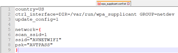

               4. Create a new file named wpa_supplicant.conf and add the following text into the file. Please note where is says your_wifi_ssid and your_wifi_password you must put your wifi SSID and Password
country=US
ctrl_interface=DIR=/var/run/wpa_supplicant GROUP=netdev
update_config=1
network={
scan_ssid=1
ssid="your_wifi_ssid"
psk="your_wifi_password"
               5. Similiary to the SSH file, make sure to remove the .txt extension from the end of the file.

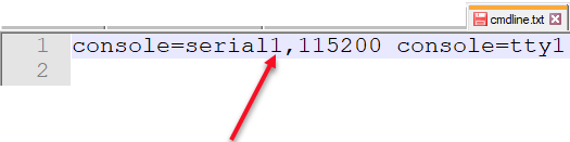

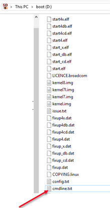

               1. For the Raspberry Pi 4 B, the default UART used by console for communicating with the SBC is the primary UART which is the same UART interface the Monarch Go Pi Hat needs to use.
                  We will need to change our console UART from primary UART to secondary UART. Open the boot directory on the SD Card in the windows explorer.
                  Open the cmdline.txt file using a text editor, change console=serial0 to console=serial1
                  See completed change in image below for reference. Make sure to save and exit the text editor

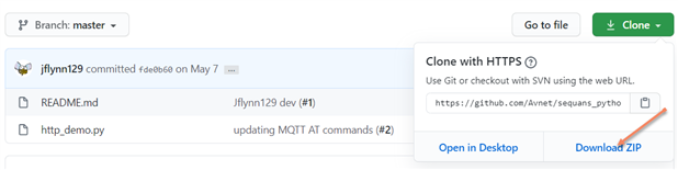

               2. Now that the console UART interface is configured correctly, lets grab the application we will be using from the Avnet GitHub.
                  Go to github.com/Avnet/sequans_python Click Clone -> Download ZIP
               3. Unzip the ZIP file and paste the http_demo.py onto the microSD Card

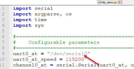

                  4. Before we eject the microSD Card open the http_demo.py application using a text editor.
                  We must edit the UART interface to use the primary UART. Change "/dev/ttymxc0" to "/dev/serial0"

               1. Set the Monarch Go Pi Hat Jumpers to Single Board Computer Operation
    • J6 : 1-3 / 2-4
    • J7 : 1-3 / 2-4
    • J10 : No Connect
               2. Connect the Monarch Go Pi Hat to your SBC 40 pin GPIO Raspberry Pi Hat

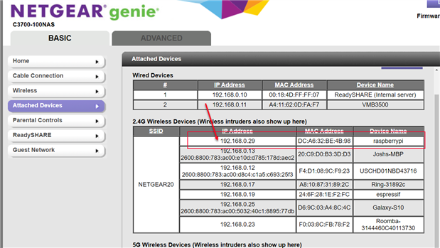

               2. Now the fun part of determing the IP address of your Raspberry Pi 4 B!
               3. In my case I logged into my router and determined the IP address of the Raspberry Pi 4 B
               4. You can refer to your router which should have information in regards to how to login to your router. Or do a quick google search on how to login to your router!
                    If you can't find your raspberry pi IP address when you logged into the modem, you most likely left the extensions on your wapsupplicant.conf file on the sd card.

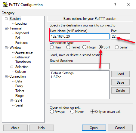

               5. Now that we have determined the Raspberry Pi IP address in my case (192.168.0.29). Open a terminal in my case putty and type in the IP address, make sure the port is 22 and SSH is selected. Then select open to start your session.
               7. You have successfully connected to the Raspberry Pi 4 B

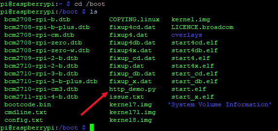

               9. Go to the boot directory in the image to find the http_demo.py application. Enter the following commands cd /boot and then enter ls to see the files in your location.

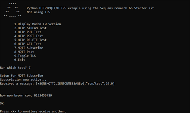

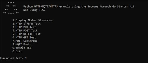

               11. Now lets run the Python3 application enter python3 ./http_demo.py You should see a menu similiar to what is shown below.
     Running the Application
               1. I'd reccomend starting with Entering 1 This will show your frimware version and verify communication between the modem and the SBC

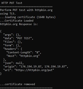

               2. For the HTTP communications examples, the script interacts with http://httpbin.org--a simple HTTP Request & Response service--by sending PUT, POST, GET, DELETE, and STREAM commands.
                   When httpbin.org receives the commands, it echos the command back.  An example using a PUT command is:
               You can also use HTTPS rather than HTTP by toggling TLS prior to issuing the command.  In the example above, TLS was enabled so the response url is displayed as "https://httpbin.org/put".

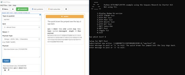

                3. Using the MQTT Interface

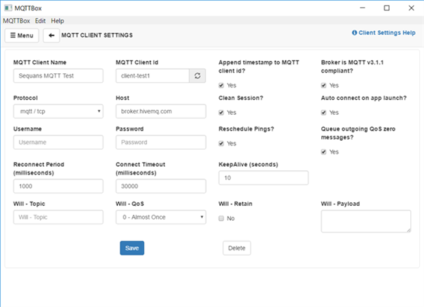

                    a.The example script also supports posting and subscribing to an MQTT exchange. To demonstrate interaction with an MQTT broker, the script uses HiveMQ and the Chrome browser application MQTTBox.
                        To begin, setup the MQTTBox application to use an MQTT Client id of 'client-test1' and a Host address of 'broker.hivemq.com'. This will allow you to monitor and post to topics from within MQTTBox.  The setup should look similar to:

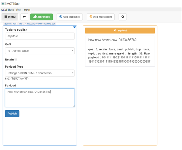

                    b.Once configured, you can monitor and post topics.  In the script, 'sqn/test' is the topic used so when posting to the Sequans module, use this topic (in the Topic to publish box) and whatever Payload you would like will be sent to this topic.
                       When the 'Publish' button is pressed, the payload will be displayed on the right side of the dialog showing the payload for the 'sqn/test' topic.  An example of this is shown below:
                    c.Using the example script provided, select either 7 or 8 to Subscribe/Post messages between HiveMQ, the MQTTBox application, and the Python script.
                       For example, in the following screen shot, an MQTT Subscribe action has been executed and the script then waits for a subscribed message to be received.
                       When the payload is posted to the 'sqn/test' topic using MQTTBox, it will also be displayed in the Python Script as shown below.
                  Similarly, when a Post is executed by the Python script (selection 8), the published message is displayed within MQTTBox as shown below:
