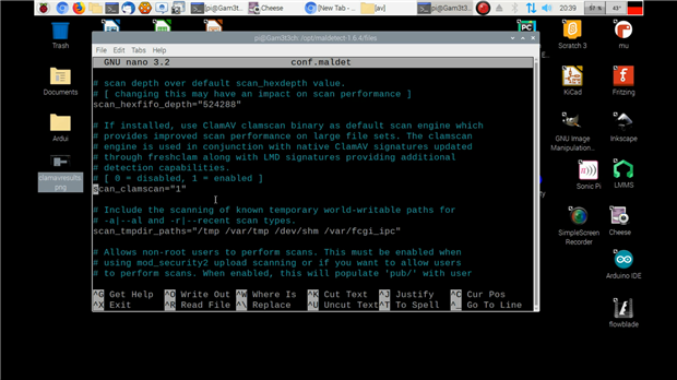

after I installed ClamAv and ClamTK I made sure that the file was set to work with ClamAv
this is set by going to /opt/maldetect-1.6.4/files
and typing: sudo nano conf.maldet
should be half way or more down the list you will see
scan_clamscan="1"
if for some reason it says "0" change it to "1"
