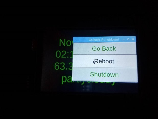

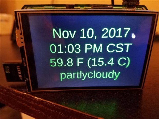

My complete github project (https://github.com/texadactyl/rpi_clock ) provides a Raspberry Pi Clock & Weather display (rpi_clock), based on the Quimat 3.5" TFT Touch Screen with a 320x480 resolution and their software housed at https://github.com/goodtft/LCD-show.  The primary Tk window displays date, time, and current weather conditions outside according to the Richardson Texas USA station of the Weather Underground.  If you touch the screen, it will bring up a secondary Tk window which offers the user to go back to the primary window, reboot, or shutdown.
You can see that I set up the primary window presentation for an American-formatted date & time presentation.  Modifying this is very simple by editing bin/rpi_clock.py constants FORMAT_DATE and FORMAT_TIME.  You can easily modify colors, fonts, widths, button sizes, etc. as you wish as they are also capitalized constants.  The weather data comes in a response from the Weather Underground using a JSON-oriented API for current weather conditions.  I chose to show temperature in both Celsius and Fahrenheit.  The conditions string ("partlycloudy" in the image above) was returned by the Weather Underground as part of its JSON response message, probably formatted for American English due to the station parameters (Richardson); I simply used it as is.

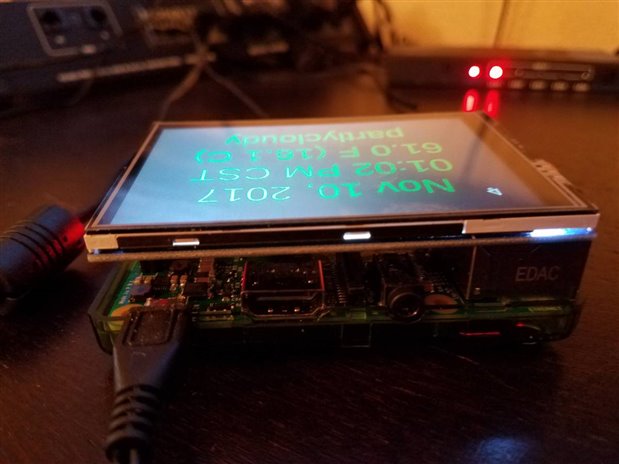

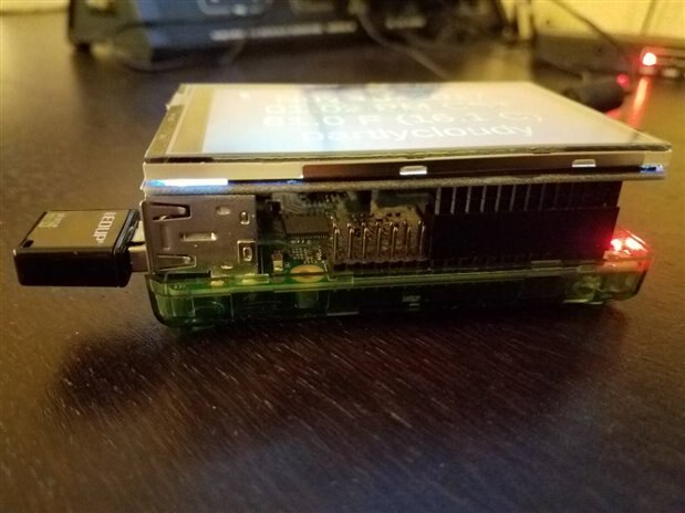

Note that the directions from Quimat (TFT supplier) were quite sparse (being generous).  You can see my complete review at Amazon (https://www.amazon.com/gp/customer-reviews/RXAU7YNHXRTIP/ref=cm_cr_getr_d_rvw_ttl?ie=UTF8&ASIN=B06W55HBTX).  There are probably better hardware solutions although this worked fine for a persistent old hacker like me. (=:  In their defense, I'll say that the display hardware pushed onto the Pi's GPIO connectors without issues; no wiring required.  However, watch out for the supplied plastic case because it is very brittle - mine broke [image] so I slapped together a semi-protective solution (bottom of a clear case in my bottom desk drawer) that covers the bottom of the Pi.  If the TFT (protecting the front of the Pi) dies because there is nothing protecting it, I'll look for another hardware vendor product.  See? I went cheap (USD 28 for TFT, touch pen, DVD-docs, and brittle clear case) and got bitten.  Lol@myself!

View from the top:
View from the bottom:
