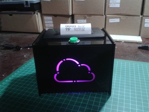

Hi everyone!
I just want to show the project that I am working on, so lets go. This time I made an IoT ticket printer for my business, it prints the orders that users made in my store webpage.
And the best of all is that the program is pretty simple, in any e-commerce platform when a client makes an order you receive an email. So this printer is conected via IMAP service to an email account that only receives this notification emails and when the email is received the software decodes and interprets the data in the message. Then, the ticket can be printed based in the received data.
You only need a Raspberry Pi, a thermal printer, a neopixel, wifi dongle, the power supply and a nice looking case(in my case this is the Adafruit case for the twitter printer).

  • spannerspencer
    spannerspencer over 11 years ago +2
    That's a superb idea for anyone who receives orders online! Great work I'll send you a copy of The MagPi for sharing that idea (can you ensure your postal address in your profile is up to date?). And if…

    justiciero24 over 11 years ago in reply to spannerspencer
    Thanks image Yes, my address that appears in my profile is correct and up to date.
    I will do it soon, maybe this weekend. Actually it extracts only the relevant information like the total and the order number, of course you can obtain all the information of the purchase if you want. But for me it's okay only with the total and the order number.
    When the email arrives it contains some html code, so I used string functions to delete all the html code and only get the information that can be used. Then, I search for the data that I need to generate the ticket and after that I save it into different strings. When I have the data that I want, the ticket is printed.
    Also the printer can detect if there is paper and only marks the email as "readed"  if the ticket is successfully printed. And if you need to print it again, you only need to go to your inbox an mark that mail as "unread".
