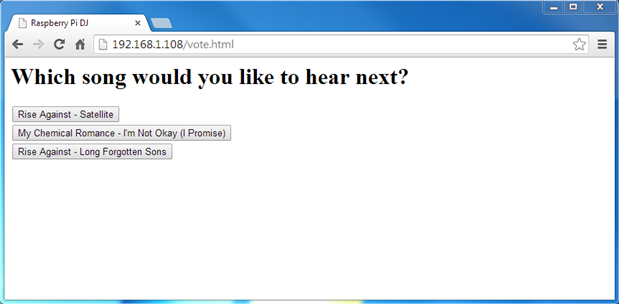

Sending Song Choices
The first step is that we need to determine what songs are in our library.  To do this, we take in a path and then read all of the files in that directory and call that our list of songs:

Then on the client, we can receive and display those songs:
socket.onmessage = function(msg) {
var data = JSON.parse(msg.data);
switch (data.type) {
case 'update':
displaySongs(data.songs);
break;
default:
displayHeader('Unknown result from server');
break;
function displaySongs(songs) {
displayHeader('Which song would you like to hear next?');
$.each(songs, function(idx, song) {
$('<button>' + song + '</button><br/>').click(function() { vote(song); }).appendTo('#info');
function displayHeader(header) {
$('#info').empty();
$('#header').html('<h1>' + header + '</h1>');
Which will look like this:
