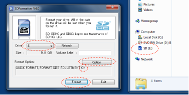

2Go to https://www.sdcard.org/downloads/formatter_4/  and follow the links on the left side to download SD Formatter 4.0 (direct link for Windows is here. scroll to the bottom and click Accept). Then install it.
3Insert SD card into PC. Confirm the drive letter (e.g. E: drive) using Windows Explorer for example
4
Run SD Formatter. Select the correct drive letter if it is not already selected. Then click “Option” and set “FORMAT SIZE ADJUSTMENT” to ON and then click OK.
Then click “Format”, and OK once or twice if it asks. It will soon say “Memory Card Format complete”. You can now exit the program.

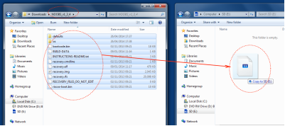

Go to http://www.raspberrypi.org/downloads/ and download NOOBS
Version: 1.3.x currently
Approx 1.3Gbyte download (.zip file) currently
6Unzip the file (right-click and Extract if you’re using Windows)image
7Select all the contents (ctrl-A will do it) and then click and drag to the SD card (E: drive in this case). This will take about a minute to complete.image

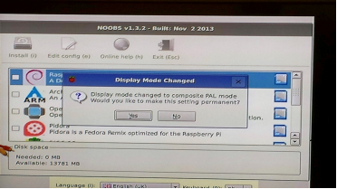

10If you are using HDMI, skip this step. Determine if your country uses PAL or NTSC TV systems. As a general rule, assume you are using PAL unless you are in Japan or USA. If you are using PAL, press the number ‘3’ on the keyboard, and keep it pressed while plugging in and powering up the RPI. If you are using NTSC, press the number ‘4’ on the keyboard and keep it pressed as you plug in and power up the RPI. If you don’t do either, then the RPI will output via HDMI and you will see nothing on the TV. Don’t release the number until you see the NOOBs information on the screen. Then you can release it.
11Power up the RPI
12
If you are not using HDMI, skip this step too. You will see a message on the screen asking if you want to make the display mode permanent. Select ‘Yes’ if this is the case*. To select it, you can use the mouse or press Tab on your keyboard until it is highlighted, and then press Enter.
* Note – if you select ‘No’ you run into a slight problem later,  because you won’t be able to shutdown the RPI without a remote connection from a PC (explained after a couple of steps below, in step 16).

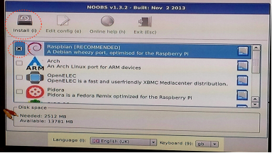

Select the Raspbian option (it is the first option here). If you don’t have a mouse, you can use the arrow keys and press spacebar.
Make any language/keyboard changes if needed.
Then press ‘i’ or click on “Install”.
Notice the NOOBs version number may be displayed incorrectly – this is a bug that you can ignore.

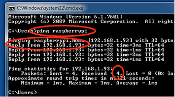

You need to find the IP address. There are a few ways. One way is to go to a PC, and type ‘ping raspberrypi’ in a command window. To open a command window on Windows, go to The Windows start menu and type ‘cmd’ in the “Search programs and files” box as indicated in the screenshot here. On Mac or Linux, you can open a Terminal window.
When you type ‘ping raspberrypi’ you should see a reply, and the ping statistics should say 3 or 4 packets were received. If you see some lost, reattempt ‘ping raspberrypi’ a second time.
Make a note of the IP address that you see. This is the IP address that the RPI acquired from the router.

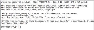

3Find SSH software. A free example is called PuTTY. Install it.
4Using your SSH software, set it up for an SSH connection to the IP address that you discovered, and username ‘pi’ and password ‘raspberry’. Select ‘Connect’. You should see the text shown on the right, or something very similar.image
5There are some config options such as changing hostname, or changing audio path, if you type ‘sudo raspi-config’. In many cases you may chose not to make any adjustments.
