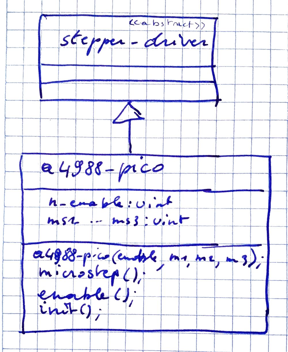

Pico C++ library for Allegro A4988 stepper driver IC.
I created a generic stepper driver library, and made a first example:  Raspberry Pico stepper driver IC library, with example: Texas Instruments DRV8711. In this post, I create a plug-in replaceable driver for that Allegro IC.
The abstract base class that I created, supports 3 functions:
  • init()
  • microsteps()
  • enable()
Those will also be the functions that the new A4900 supports. While the TI IC in my first post used SPI for all configurations, this IC uses input pins:
image source: allegro a4988 datasheet
The pins that I want to control are the 3 microstep pins, and enable.I don't program sleep and reset. Both are pulled to VDD to disable them.
This is how the class will be used in the code:

In the firmware, it will now work exactly the same as the TI DRV8711 of the previous post. No code changes needed.
Pico A4988 driver class
This is the class you'd instantiate, if you want to control a A4988 on a Pico:
class a4988_pico: public stepper_driver::stepper_driver {
public:
    a4988_pico( uint n_enable, uint ms1, uint ms2,  uint ms3) :
        n_enable_(n_enable), ms1_(ms1), ms2_(ms2), ms3_(ms3) {}
    virtual inline  bool init() override {
        init_gpio();
        return true;
    virtual bool microsteps(unsigned int microsteps) override {

In action
Check the previous (DRV8711) post. This class makes the A4988 behave in exactly the same  way.
The protocol is different: GPIO instead of SPI, but the API is identical.
