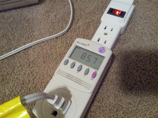

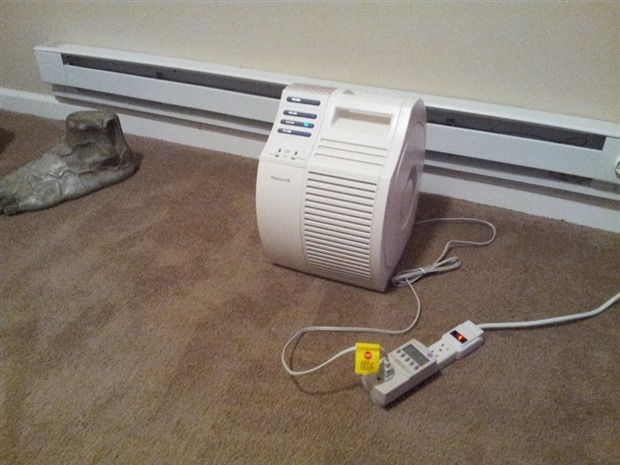

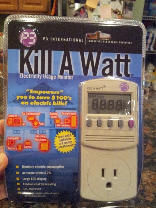

Say you want to know how much electricity an appliance like an air purifier is consuming?
You can hook it up to the nifty Kill-A-Watt power meter (aka KaW).  The KaW will keep track of and display the killowatt-hours, or kWh, used by the plugged in device.

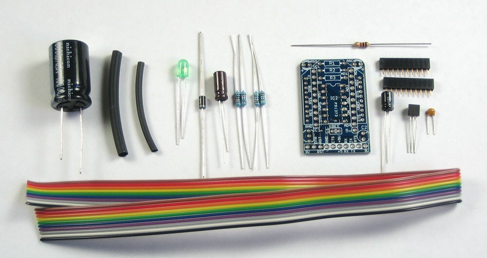

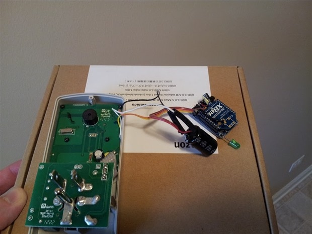

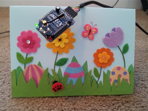

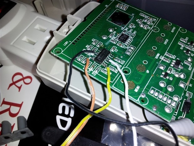

However, the total will be reset anytime the KaW is unplugged and loses power.  Limor Fried (aka ladyada) recognized this shortcoming and created the clever Tweet-A-Watt project back in 2009. She modded the KaW into a wireless data logger by soldering a XBee wireless module to the KaW's op-amp chip:

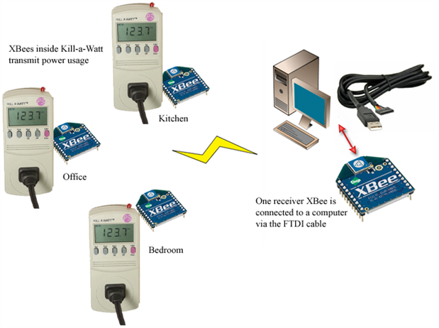

The XBee's built-in ADC reads the power sensor signals inside the KaW and transmits it to a receiver XBee module connected to a computer via USB.  This diagram by ladyada gives a good sense of the architecture:
(source: http://www.ladyada.net/make/tweetawatt/)

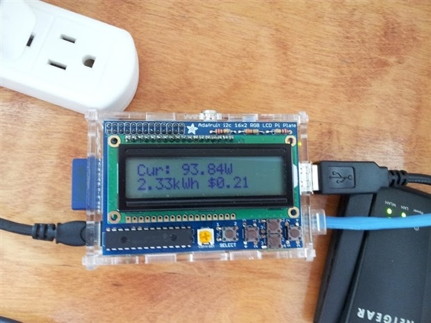

The Tweet-A-Watt (TaW) is an awesome project, but I felt it's requirement to have a computer receive the data was cumbersome and power hungry.  Thankfully, we now live in an world of powerful, tiny & cheap single board computers (SBCs) like the Raspberry Pi .  I decided to use the Pi in place of a traditional computer.  I also used the Adafruit LCD Pi Plate to display the power usage data. and the Adafruit Pi Box enclosure to protect the Pi (which has a convenient "convertible" mode to accommodate the LCD Pi Plate on top):

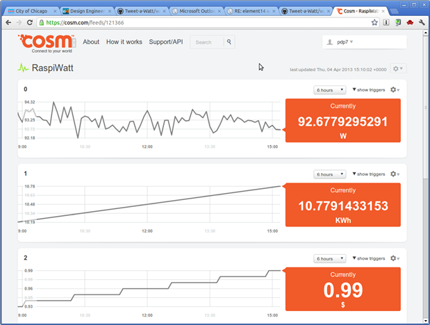

Ladyada used Google AppEngine for graphing the TaW data, but I decided to take advantage of the newer Cosm graphing service (formerly named Pachube).  Here is a screenshot of my RaspiWatt Cosm feed showing Watts, kWh, and USD$ (based on the cost of a kWh for my power company):

1Adafruit Tweet-A-Watt starter pack Includes 2 XBee radio modules and adapter boards; components to mod the XBee transmitter; FTDI USB-to-serial cable

52W90851Adafruit RGB LCD Pi Plate Displays current power usage; intend to use it's buttons to create simple UI

    FYI, I found out the hard way that you DO need the adafruit xBee shield for programing.
    e14 Contributor over 13 years ago in reply to fustini +1
    Me too. I was trying to avoid buying more than I needed, as I already had several SparkFun XBee Explorers. My guess is the FTDI vs USB cable. Have you or anyone else set up the COSM code for more than…
  • felixemman
    felixemman over 13 years ago +1
    Hye guys in my case the XBEE didn't work because it was drawing too much power from the KillAWatt and causing the screen to flicker and turn off. I created my own version of the Tweet A Watt using a Moteino…
