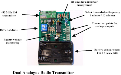

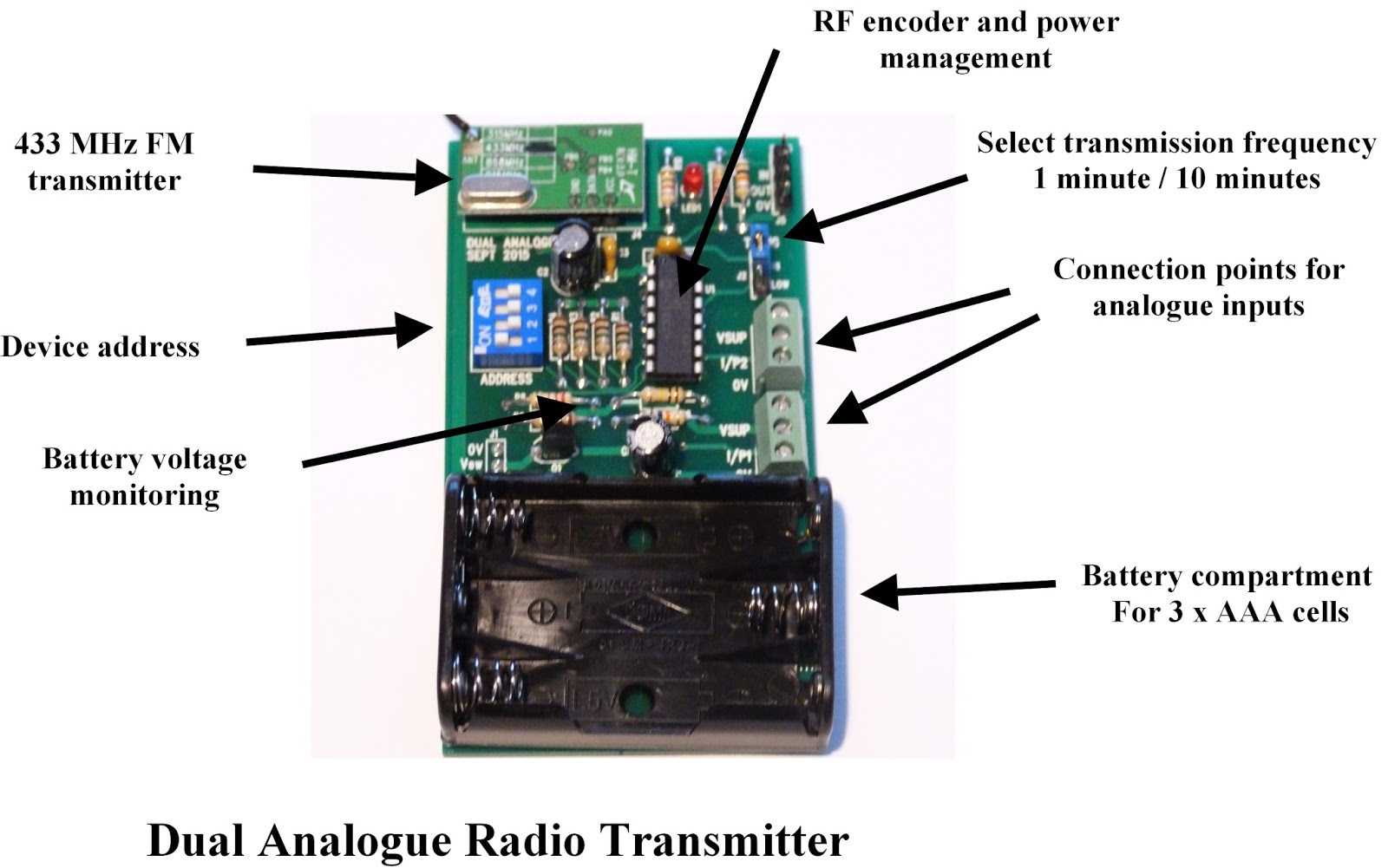

This post shows how to use the Dual Analogue Radio Transmitter (DART) and the Universal Radio Receiver (URR) to monitor the temperature of one or more freezer.
The DART collects data from 2 analogue inputs and transmits this to a receiver using a 433 MHz FM radio module. (FM radio modules gives gives significantly better range and noise performance when compared to AM modules). More information on the DART and URR can be found here.

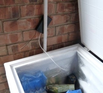

On this project uses 2 TMP36 devices. One is connected directlty to the screw terminals and the other is on a cable of approximately 1 metre in length. The TMP36 at the end of this is housed in a plastic tube for protection.
  The image below shows the DART in pace with one of the TMP36 device inside the freezer and one outside. This way we can monitor the temperature inside and outside the freezer (which in this case is in the garage).

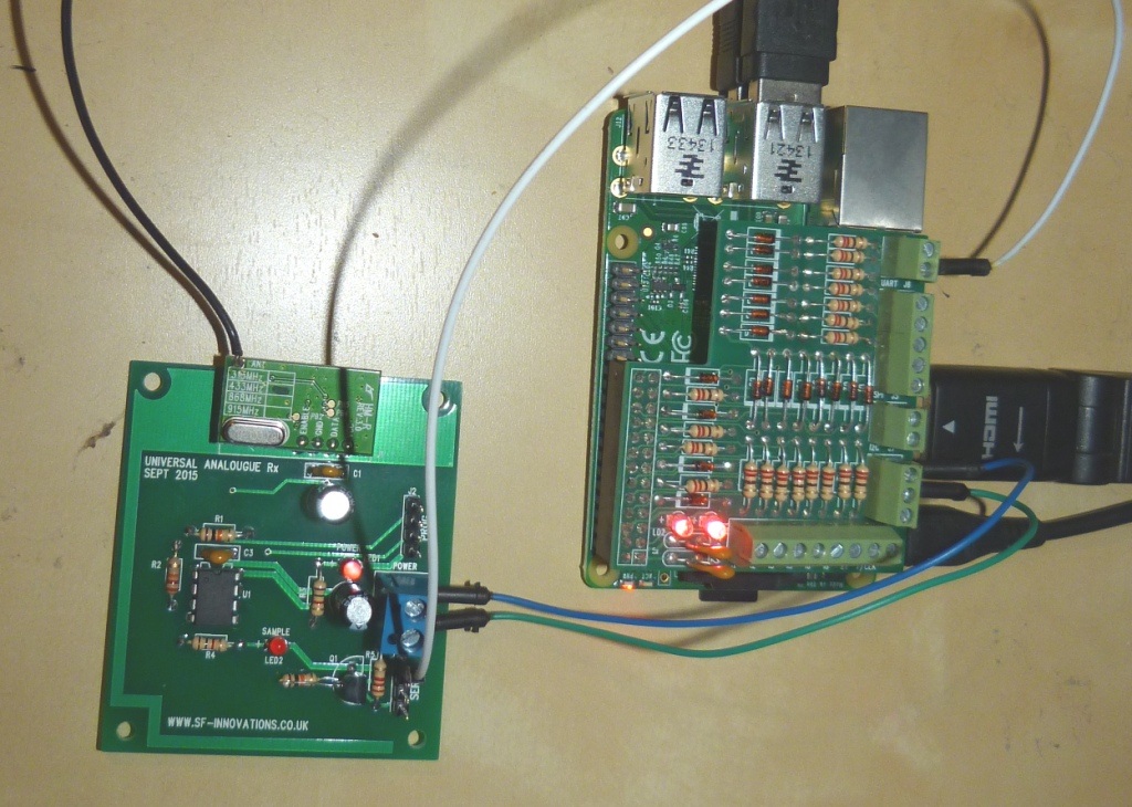

The Universal Radio REceiver is connected to a Raspberry Pi, using A Custard Pi 1A breakout board. (This has easy connection points and also has 0.1A fuses on the 5V and 3.3V rails to prevent too much current being drawn from the RPi.)
The Python code to receive the data on the serial port is listedat the end of this post. Please read this document for more comprehensive instructions on using the UART on the Raspberry Pi.

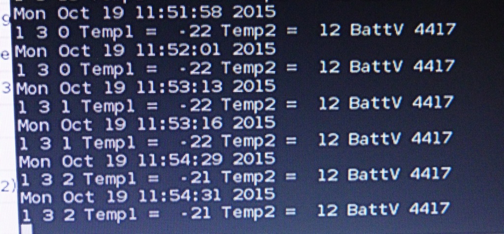

The data displayed on the HDMI monitor connected to the Raspberry Pi is hsown here.
The data is received every minute and is interpreted as follows.
1st digit = device type )always 1 for a DART)
2nd digit = address set on this DART
3rd digit = data count (goes from 0 to 15 and then starts again. Each data set is sent twice)
4th digit = temp 1 = -21 deg C (inside the freezer)
5th digit = temp 2 = 12 deg C (in the garage)
6th digit = batt voltage = 4.417 V
