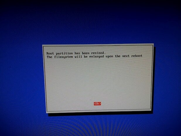

I had been using the current official Debian "squeeze" image (debian6-19-04-2012) for awhile now, so I decided to try out some of the newer images last weekend.  First off, I tried out the Debian "Wheezy" Beta image.  It includes a great configuration tool called raspi-config which runs at first boot:
The expand_rootfs option will automatically expand the image to utilize the full size of your SD card.  I think this is really handy for novice users:
