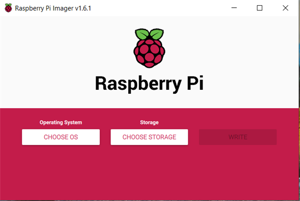

     1. Downloading the softwares :
    • Go to the official Raspberry Pi Downloads page and download the Raspberry Pi Imager and the Raspbian operating system.
    • Leave the Raspbian zip file as it is. You don't need to extract it.
    • For this tutorial I have used the Raspberry Pi OS with desktop (without recommended software).
    • After downloading, install the imager.
    • The imager window will look like this:

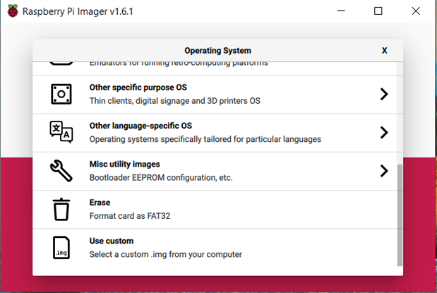

    • First, we need to format the card to delete the previous content. It can be done with any software. Here, I am using the imager itself to format the card.
    • Go to 'CHOOSE OS', then click on 'Erase'.
    • Now, click on 'CHOOSE STORAGE'.
    • It will show the list of external storage devices connected to your PC.
    • Select the appropriate card from the list.
    • Now click on .
    • After the card gets formatted, again click on 'CHOOSE OS'.
    • Then click on 'Use custom'. This will let you browse for a custom OS on your PC.
    • Browse the Raspbian image that you downloaded earlier and select that.
    • Then, again select the card from the Storage list.
    • Now, click on 'WRITE'.

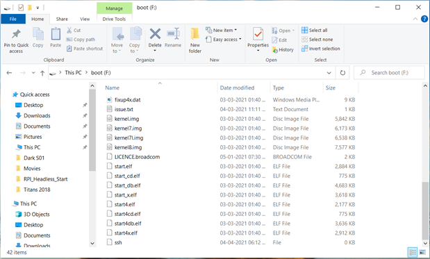

     3. Enabling SSH :
The SSH (Secure Shell) protocol is a method for secure remote login from one computer to another. We will use SSH to login to the PI using our PC.
    • Now, again insert the SD Card into the card reader.
    • The flashing process creates two partitions in the card. One of them is the 'boot' partition which stores all the files necessary for booting up the PI.
    • To enable SSH, create an empty file with name 'ssh' without any extension as shown below:
    • Remove the card from the reader. Now you are ready to start the PI
Upon boot up, the PI will search for the ssh file in the boot directory and if it is present, the PI will enable the SSH and automatically delete this file.

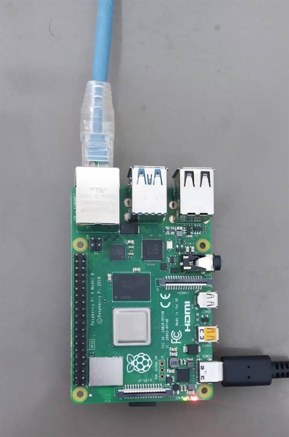

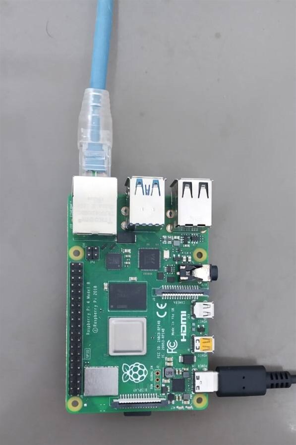

     4. Booting up the PI :
    • Now, insert the card into the PI and connect to the power supply.
    • Connect the PI to your PC using the ethernet cable.
    • Now, turn on the power.
    • The red LED shows that the board is getting power.
    • The green LED indicates SD Card activity.

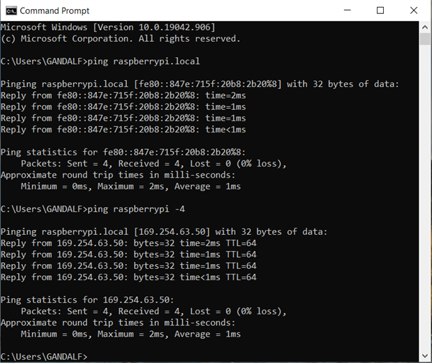

In this section we will try to reach our PI using the ping command. Ping is a command which is used to troubleshoot connectivity and
reachability of a device.
    • Now, open the command prompt on your PC.
    • Then type the following command and hit enter:
      ping raspberrypi.local
    • It will check the connectivity with your PI and give you the ipv6 address of the PI.
      ping raspberrypi -4
    • This will show you the ipv4 address (note it down) of your PI as shown below:

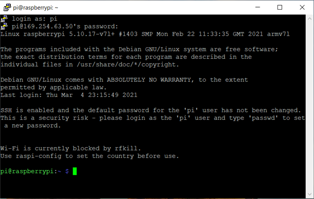

     6. Connecting to the PI terminal via SSH :
We will use puTTY to emulate our PI terminal.
    • Go to the puTTY official page and install the latest version.

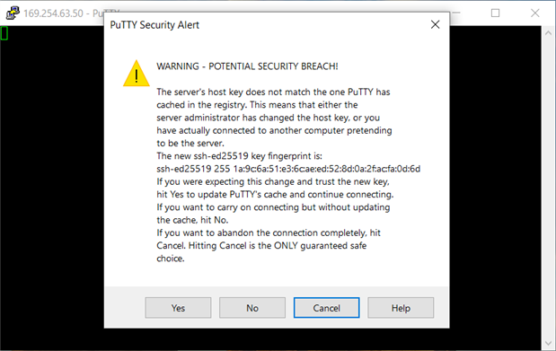

    • Now open puTTY and enter the ip address of your PI as shown below:
    • Now click on 'Open'.
    • A warning might displayed on the screen as given below. Just read it and then click on 'Yes'.
    • Now, you will be asked for your username and password.
    • The default username and password for raspberry pi are: 'pi' and 'raspberry', respectively.
    • Type the username and password and hit enter.
    • The first login might take some time. Be patient.
    • You will have logged into your PI successfully.
    • Now, you can work on the PI terminal.

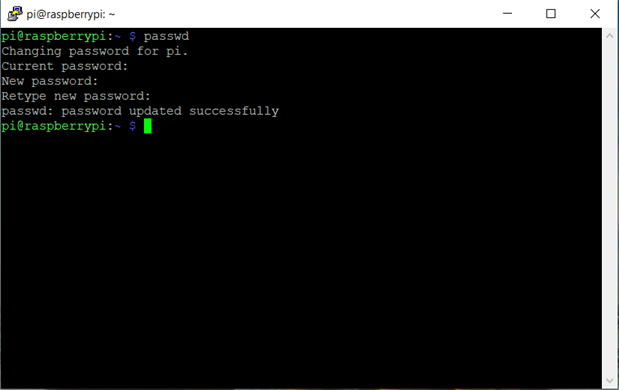

     7. Changing the default password :
    • To change the password for your PI, enter the following command and hit enter:
      passwd
    • You will be asked to enter your current password which is 'raspberry'. Just type it and hit enter.
    • Now, you will be asked to enter your new password. Enter it.
    • Then, retype the password and hit enter.
    • Now, your password has been changed.

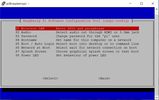

The 'raspi-config' is a configuration tool in Raspbian. It enables you to configure various settings of your OS. Use the arrow keys to navigate through the window. After finishing your configuration, it will ask to reboot your PI.
     1. Connecting to WiFi network :
    • Turn on wireless hotspot from your mobile phone.
    • Now, in the PI terminal, type the following command:

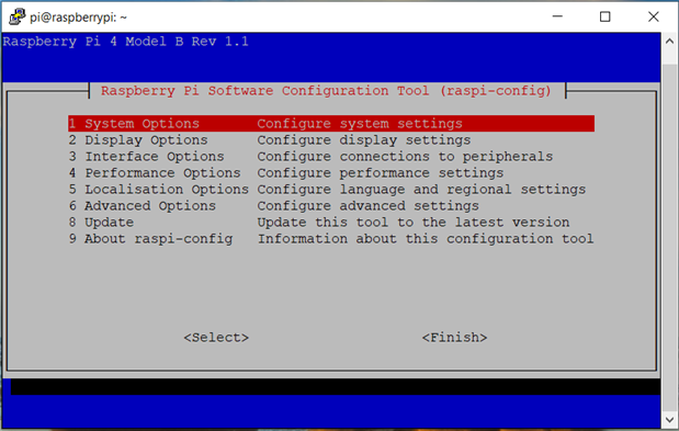

      sudo raspi-config
    • It will open a window with various settings as shown below:
    • Enter the 'System Options' menu.
    • Now, enter the 'Wireless LAN' menu.
    • Select your country from the list.
    • Then, enter your SSID and Password.
    • After hitting enter, your PI will get connected to your mobile hotspot within few seconds.
    • You don't need to reboot your PI after doing this setting.
    • After doing the above setting, everytime you turn on your PI and your mobile hotspot, the PI should automatically get connected to it in few seconds.

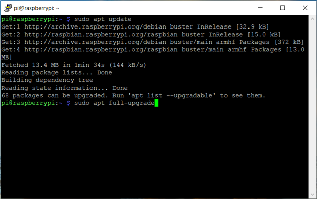

     2. Upgrading the PI :
    • Enter the following command to update your PI:
      sudo apt update
    • This command will download the list of all the latest packages and from where to download them from.
    • Now, enter the following command to upgrade your PI:
      sudo apt full-upgrade
    • This command will download all the latest packages and upgrade the OS.
    • This will take a few minutes to complete.

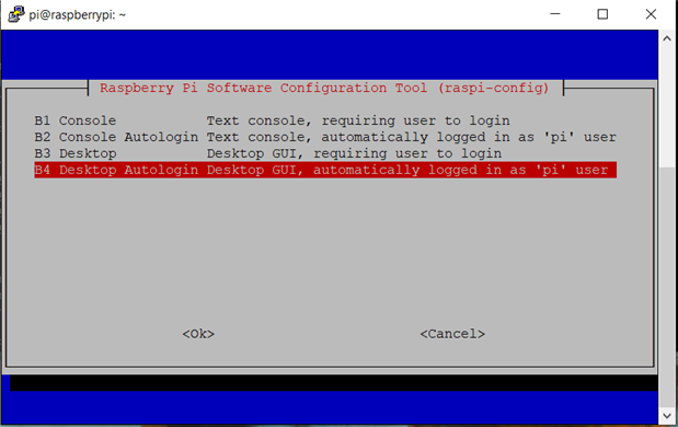

     1. Changing boot option and resolution:
    • Open raspi-config.
    • Go to 'System Options ---> Boot/Auto Login'.
    • Select 'Desktop Autologin' and hit enter.
    • Now, go to 'Display Options ---> Screen Resolution'.
    • Select the 1080p resolution and hit enter.
    • Now, reboot your PI to apply the changes.

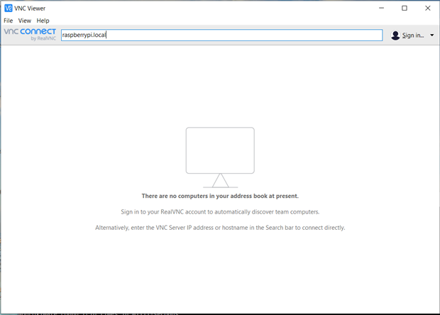

     3. Viewing PI Desktop on VNC viewer:
We will be using the VNC (virtual network computing) viewer to view the PI Desktop. VNC is a graphical-desktop sharing system which enables us to control any remote computer. The latest Raspbian packages come preinstalled with VNC server, we just need to activate it and download a viewer on our PC.
    • Open 'raspi-config' on the PI terminal.
    • Go to 'Interface Options ---> VNC' and enable it.
    • Now, you can log out of your puTTY SSH terminal by typing 'exit' and entering.
    • Download and install the VNC Viewer from this page on your PC.

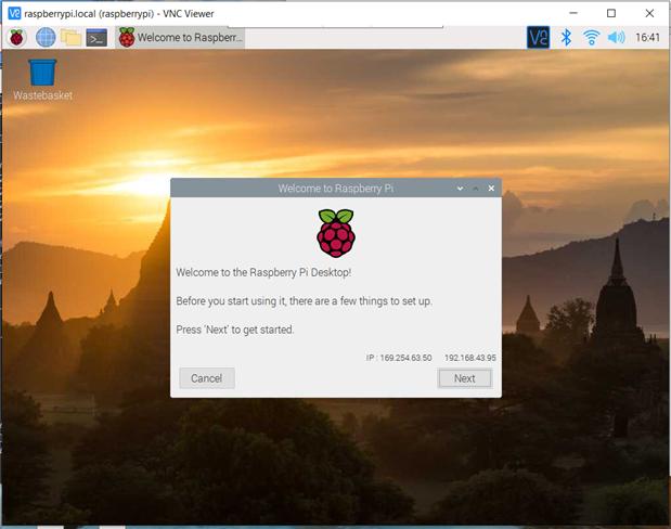

    • Enter 'raspberrypi.local' in the search bar and hit enter as shown below:
    • After some time it will ask for the PI username and password. Enter them and you are ready to go.
    • The PI Desktop will look like this:
