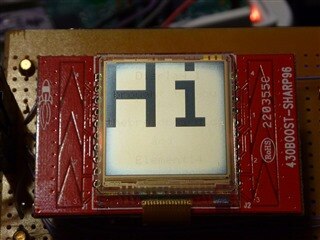

OK, so continuing  the series on PI 2 with windows 10 for IoT, I have now added to the previous app and created a demo app for a pair of Sharp 96*96 LCD displays
Again, there where no libraries for the boards. The LS013B4DN04 SPI display is the actual Sharp part and I wrote a library to drive as many of these as you have GPIOpins free on the PI, I then proceeded to put a cool UI ontop of it so I can play with the board under Windows 10.

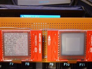

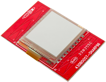

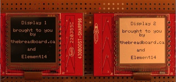

This is a view of the boards I used, you could just as easily use the Adafruit version without changing the software
This is the strip board i made up for the demo, it has minimal wiring so no need to bother with a schematic

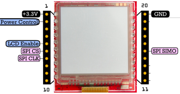

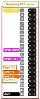

there are a total of 6 wires to the PI as shown below, Power control and LCD Enable both are tied to 3.3V, one display SPI CS goes to GPIO5, one to GPIO6
probably the easies setup for the hardware yet image

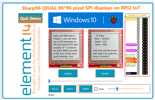

So this is the UI I created in full technicolour image
The video explains it all but in summary

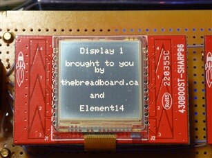

The two displays have a textbox overlay so you can input your own text and send it to the displays, the long slider will allow you to change the font size. While the display library will support multiple fonts sizes on the screen at once along with graphics elements, the demo does not show this (Yet). clicking wither of the "Update" buttons will send the display content to the respective SPI SHARP96 Display, the left one is connected to CS GPIO5, the right to GPIO6 (The code could be changed easily to use and available GPIO pin).
The fill 1's and 0's will fill a 2D array in memory for each display with all 1's or all 0's depending on the button. All 1's is actually the light grey colour, the 0's gives you a mirror basically as the reflective index of these displays is so high.
The demo button runs through a set of patterns and showcases some of the libraries capabilities

UPDATE: 13th August 2015:- Minor update to the VCOM routine to prevent screen BIAS effect, I noticed it was not working so I fixed it. the problem was it flipflops the bit but as I was doing it twice for each tick due to two displays, each display never got the alterate bit so it did not work. I moved the bit to the Sharp96Display class to it is unique to each display and adapted the routing. Now working well.
Here is what happens without it, the right display (On the first image) is supposed to be an even gray, as you can see, the old image remains
the other image was the result of being left on all night but with the bug i found unfixed and the third image shows what you see when you put another image on the display, as you can see, there is still text from the previous text
Now with the working code, the images will over a few minutes or more, fix themselves to no real harm done but somthing to pay attention to.
The attached code now contains the fix. image
