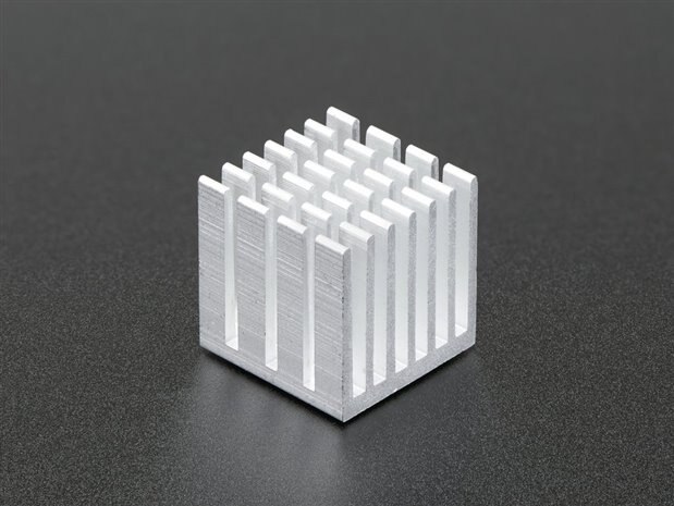

15 x 15 x 15mm Aluminum Heatsink is perfect fit for this case.
5v Fan brings cool air over the heatsink on the Broadcom BCM2837
A  piece of recycled Metal Screen protects the air inlet of the fan.
To allow hot air to escape the enclosure,  a series of exhaust ventilation holes were created.

    The fan keeps the pi at about 32 C with the back cover attached.
    A fan is not necessary, but use of a heatsink is recommended.
