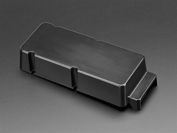

SmartiPi Touch Back Cover - Large
https://www.adafruit.com/product/3570

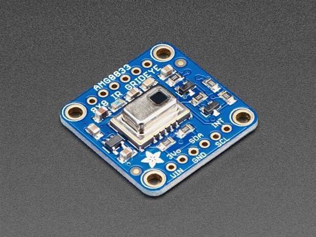

Adafruit AMG8833 IR Thermal Camera Breakout
https://www.adafruit.com/product/3538

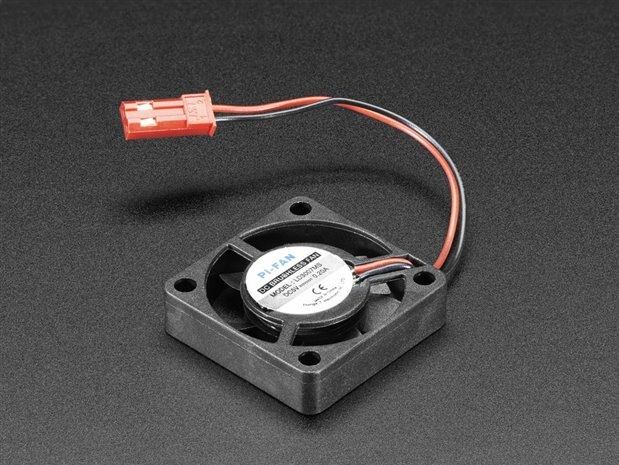

Miniature 5V Cooling Fan for Raspberry Pi
https://www.adafruit.com/product/3368

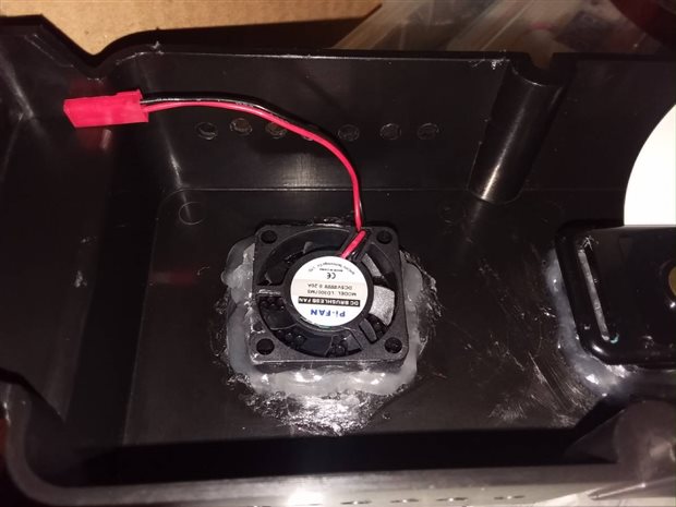

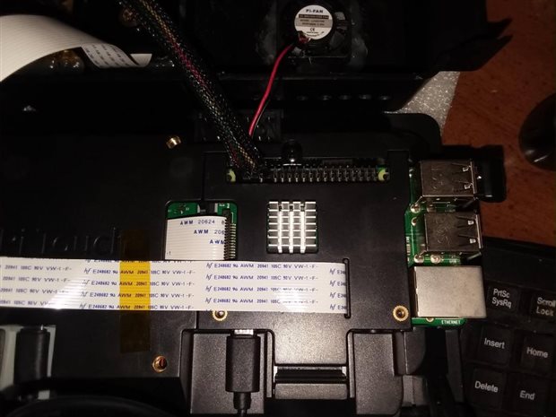

The Build

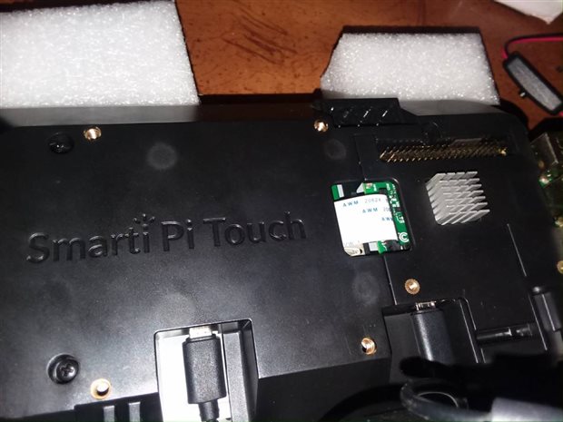

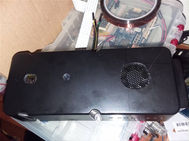

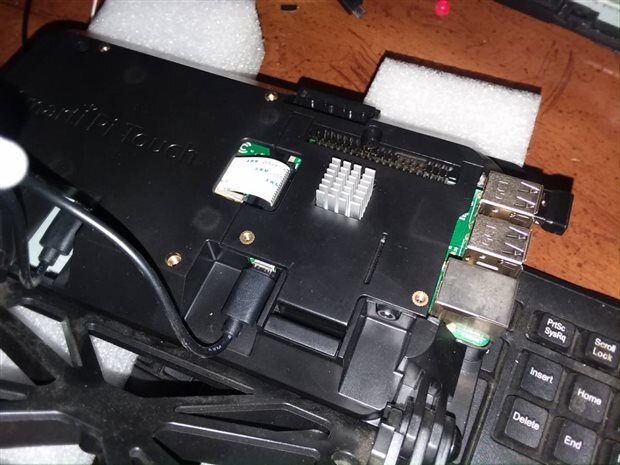

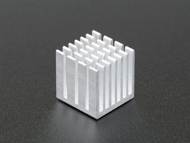

15 x 15 x 15mm Aluminum Heatsink is perfect fit for this case.

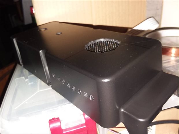

5v Fan brings cool air over the heatsink on the Broadcom BCM2837
A  piece of recycled Metal Screen protects the air inlet of the fan.

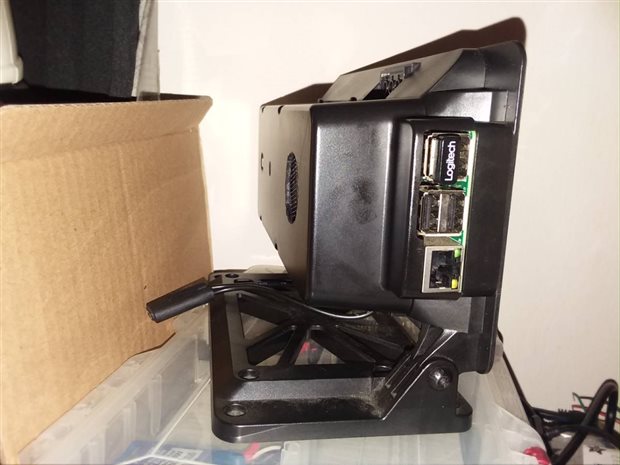

To allow hot air to escape the enclosure,  a series of exhaust ventilation holes were created.

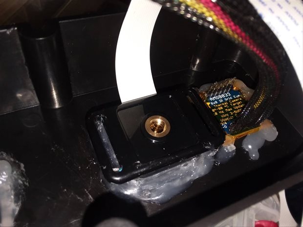

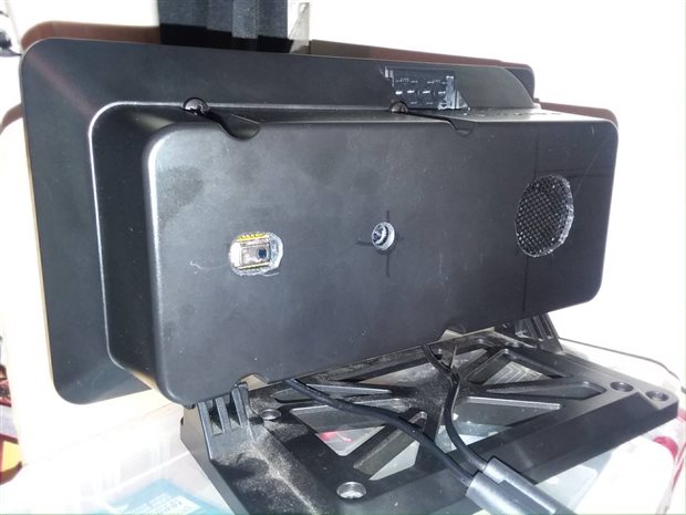

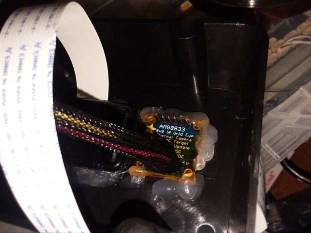

The Pi NoIR Camera is in an Adafruit Case with a 12" CSI Ribbon Cable.
The  AMG8833AMG8833 IR Grid Eye Thermal Camera has been wrapped in High Temperature Polyimide Tape (Kapton) and secured with hot glue.
Installation of the back cover is quick and easy. The cover is secured by four screws in the VESA mounting holes.
There is still plenty of room under the back cover for additional components.

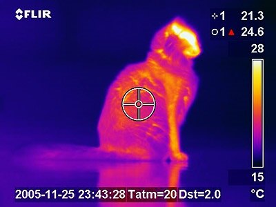

IR Thermogram Self Portrait

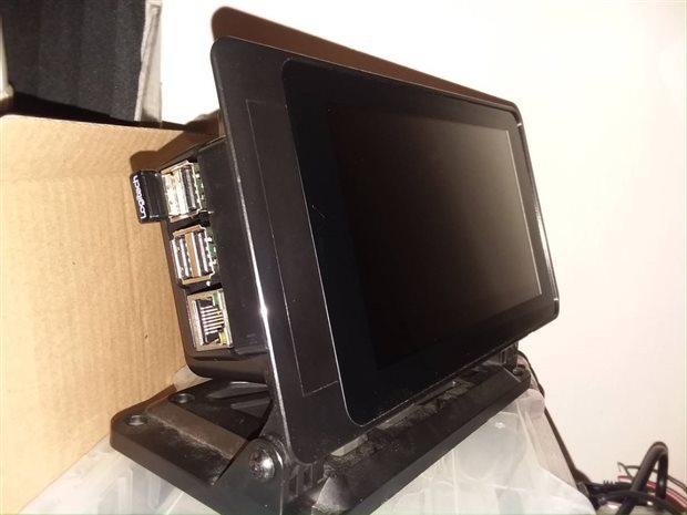

    The SmartiPi Case is a well made Pi case designed to fit the 7" display. The back cover is mounted to the holes that are used for VESA mount. It is so handy, it should be an official Pi accessory. Smarticase…
    Smarticase makes innovative cases for the pi.
    I highly recommend this case. It is my fav by far.
    It would be a great setup for a 3d printcontroller, low cost industrial automation, smart home iot and automation, POS and food service auto., and a vast number of other applications.
    So far this pi is a night vision camera and ir thermal cam built on a full raspbian touch-capacitive desktop.
