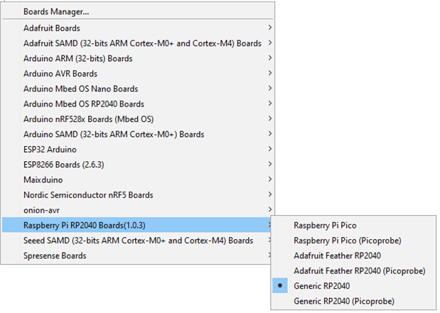

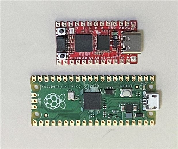

Now that I've discovered that I can program the RPi-Pico using the Arduino IDE (with Arduino-Pico or Mbed libraries), it's time to branch out and try some other RP2040 boards.
The board I think that I'll may use a lot initially is the SparkFun Pro Micro RP2040 .  It has a good tradeoff of size, cost and features.
I like the smaller size, the USB-C and Qwiic connectors, and the addition of a Reset button and a NeoPixel LED plus 16MB of external flash memory.  It has sufficient IO for most projects that I tend to work on.  It does cost more @ $9.95.

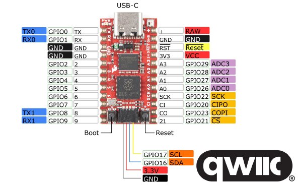

Unfortunately this board configuration does not exist in the Arduino-Pico or Mbed board libraries yet.  I thought as an experiment that I could modify the Generic RP2040 description in Arduino-Pico and if that works, I could create a new board configuration.
I realized as I looked at the variant files (pins_arduino.h) that I could probably just use the RPi Pico configuration if I could figure out an easy way to change the I2C pins to the Qwiic connector connections (GPIO 16, 17).
It turns out that in the latest version of the Arduino-Pico board library (1.1.0) that you can now set the pins used by the TwoWire class.  E.G. Wire.setSDA(pin#) and Wire.setSCL(pin#) for the first i2c0 bus (substitute Wire1 for the i2c1 bus).

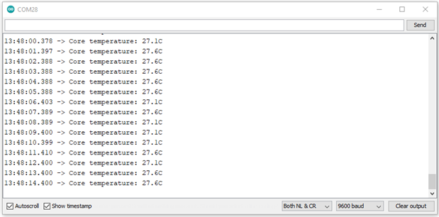

I did 3 quick tests with Arduino-Pico:
  1. Core temperature
  2. OnBoard NeoPixel
  3. BME280 using Qwiic connector
Core Temperature test - basically code is not changed from RPi Pico example.  Putting my finger on top of the RP2040 got the temp to drop about 0.5C

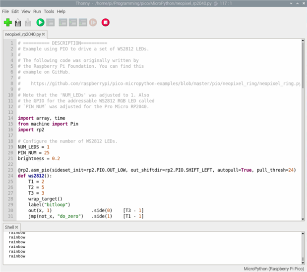

OnBoard NeoPixel - this is on GPIO 25, the same as the RPi Pico LED. I took the Adafruit example and reduced the NeoPixel count to one and set the LED_PIN to 25.

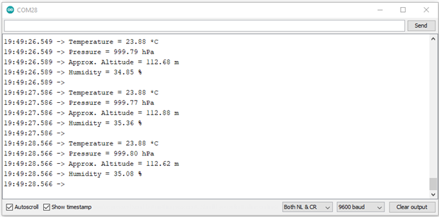

BME280 test - this is again just the Adafruit example code modified to change the I2C pins to GPIO 16, 17 and set the device address at 0x76 (I don't use the addr pullup)

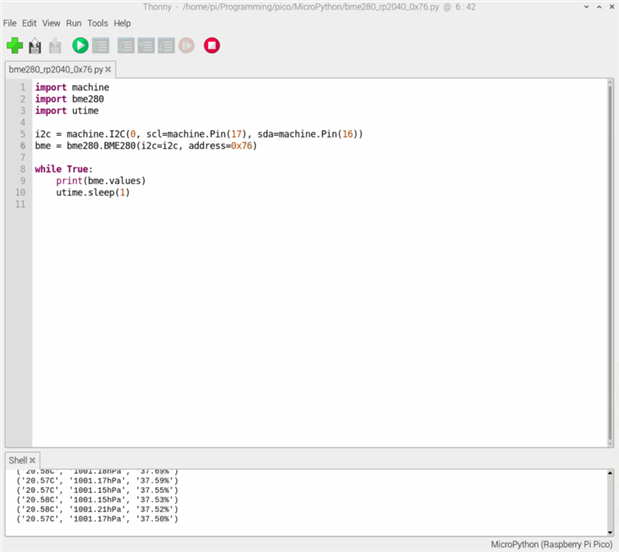

MicroPython

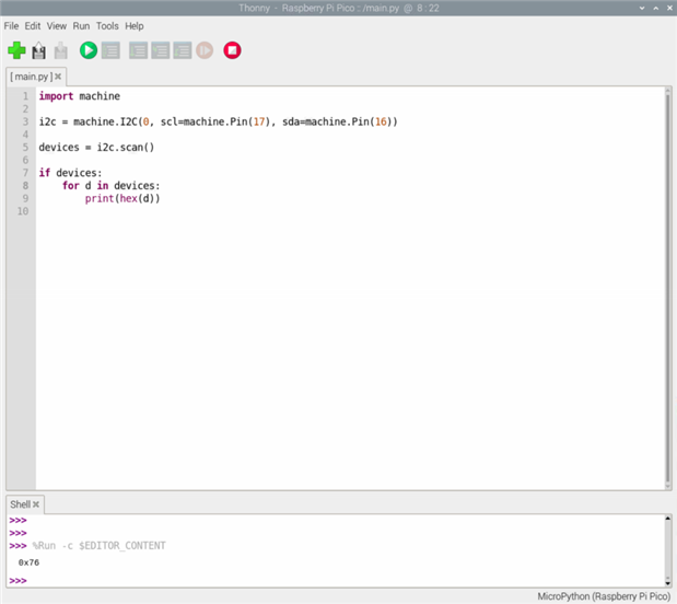

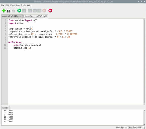

For completeness I decided to do the same 3 tests using MicroPython on my RPi400.
Core temperature
OnBoard NeoPixel
neopixel_rp2040.py
# ========== DESCRIPTION==========
# Example using PIO to drive a set of WS2812 LEDs.
# The following code was originally written by
# the Raspberry Pi Foundation. You can find this
# example on GitHub.
#    https://github.com/raspberrypi/pico-micropython-examples/blob/master/pio/neopixel_ring/neopixel_ring.py
# Note that the 'NUM_LEDs' was adjusted to 1. Also
# the GPIO for the addressable WS2812 RGB LED called
# `PIN_NUM` was adjusted for the Pro Micro RP2040.
import array, time
from machine import Pin
import rp2
# Configure the number of WS2812 LEDs.
NUM_LEDS = 1
PIN_NUM = 25
brightness = 0.2
@rp2.asm_pio(sideset_init=rp2.PIO.OUT_LOW, out_shiftdir=rp2.PIO.SHIFT_LEFT, autopull=True, pull_thresh=24)
def ws2812():
    T1 = 2
    T2 = 5
    T3 = 3
    wrap_target()
    label("bitloop")
    out(x, 1)               .side(0)    [T3 - 1]
    jmp(not_x, "do_zero")   .side(1)    [T1 - 1]
    jmp("bitloop")          .side(1)    [T2 - 1]
    label("do_zero")
    nop()                   .side(0)    [T2 - 1]
    wrap()
# Create the StateMachine with the ws2812 program, outputting on pin
sm = rp2.StateMachine(0, ws2812, freq=8_000_000, sideset_base=Pin(PIN_NUM))
# Start the StateMachine, it will wait for data on its FIFO.
sm.active(1)
# Display a pattern on the LEDs via an array of LED RGB values.
ar = array.array("I", [0 for _ in range(NUM_LEDS)])
def pixels_show():
    dimmer_ar = array.array("I", [0 for _ in range(NUM_LEDS)])
    for i,c in enumerate(ar):
        r = int(((c >> 8) & 0xFF) * brightness)
        g = int(((c >> 16) & 0xFF) * brightness)
        b = int((c & 0xFF) * brightness)
        dimmer_ar[i] = (g<<16) + (r<<8) + b
    sm.put(dimmer_ar, 8)
    time.sleep_ms(10)
def pixels_set(i, color):
    ar[i] = (color[1]<<16) + (color[0]<<8) + color[2]
def pixels_fill(color):
    for i in range(len(ar)):
def color_chase(color, wait):
    for i in range(NUM_LEDS):
        time.sleep(wait)
        pixels_show()
    time.sleep(0.2)
def wheel(pos):
    # Input a value 0 to 255 to get a color value.
    # The colours are a transition r - g - b - back to r.
    if pos < 0 or pos > 255:
        return (0, 0, 0)
    if pos < 85:
        return (255 - pos * 3, pos * 3, 0)
    if pos < 170:
        pos -= 85
        return (0, 255 - pos * 3, pos * 3)
    pos -= 170
    return (pos * 3, 0, 255 - pos * 3)
def rainbow_cycle(wait):
    for j in range(255):
            rc_index = (i * 256 // NUM_LEDS) + j
            pixels_set(i, wheel(rc_index & 255))
        pixels_show()
        time.sleep(wait)
BLACK = (0, 0, 0)
RED = (255, 0, 0)
YELLOW = (255, 150, 0)
GREEN = (0, 255, 0)
CYAN = (0, 255, 255)
BLUE = (0, 0, 255)
PURPLE = (180, 0, 255)
WHITE = (255, 255, 255)
COLORS = (BLACK, RED, YELLOW, GREEN, CYAN, BLUE, PURPLE, WHITE)
print("fills")
for color in COLORS:
    pixels_fill(color)
    pixels_show()
    time.sleep(0.2)
print("chases")
    color_chase(color, 0.01)
while True:
    print("rainbow")
    rainbow_cycle(0)
BME280_test
First I scanned to verify that I could see the be280 on the Qwiic connector
Then ran the test
Looks good so far...  think I'll try using the external flash for logging sensor data next.

    There are pads on the bottom to break out the USB pins and the SWD data and clock. Also almost forgot - the DO from the NeoPixel.

    I like that they kept with the castellated connections. Are there any traces on the bottom that could get shorted if it was soldered to another card?
    dougw over 5 years ago
