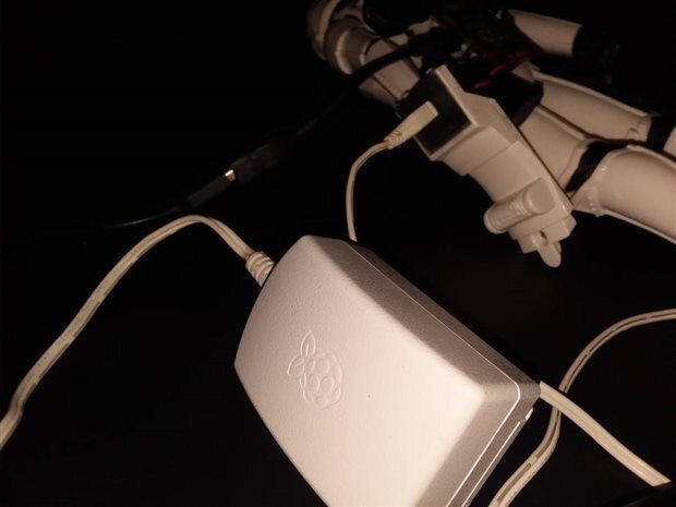

On the 16GB microSD the most recent Raspbian Stretch Lite has been installed. https://www.raspberrypi.org/downloads/raspbian/
For power, a Raspberry Pi 5.1V 2.5A microUSB Power Supply available at http://www.newark.com/stontronics/t5875dv/psu-raspberry-pi-5v-2-5a-multi/dp/77Y6535
For the first boot, I like to use the HDMI connected to a TV in order to set up and configure the Pi Zero W.
Afterwards all connection is established thru SSH.
Testing the Stormtrooper Pi Radio
With everything connected, installed , and reassembled, we can find out if this crazy idea will actually work.
The only change to the external appearance of the Stormtrooper is the micro USB port on the back.
The following demonstrations were performed by issuing commands to the Pi Zero W from PC by SSH connection. Type alsamixer for volume control.
