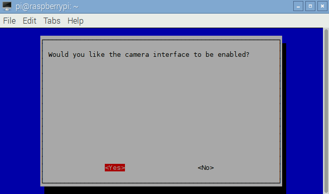

After the camera is physically connected you have to enable it. This is done using the native Raspberry Pi configuration tool - raspi-config. Run the tool using the command below.
sudo raspi-config
A menu with different configuration options will appear. Navigate to
Enable camera and press enter.
Select Yes option and press enter.
From the main menu exit raspi-config by pressing the right arrow twice to navigate to the "<Finish>" option and press enter to exit. You will be prompted to reboot your Raspberry Pi for changes to take effect - select Yes.

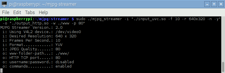

RUN MJPG-STREAMER SERVER
The command below will run the server.
sudo ./mjpg_streamer -i "./input_uvc.so -f 10 -r 640x320 -n -y" -o "./output_http.so -w ./www -p 80"
If you see an output similar to the one below it means that the server is running correctly

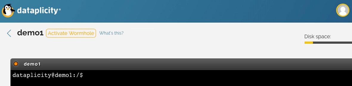

ENABLE WORMHOLE
If you haven't already done so, log in to your Dataplicity account and go to the device (e.g. the Pi) you want to link to. At the top of the page will be a link to 'Activate Wormhole'.
Press it and enable Wormhole. The link will contain your device ID.
