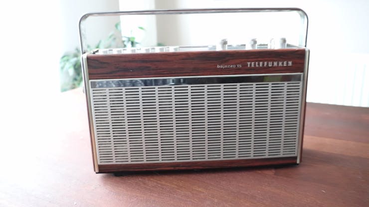

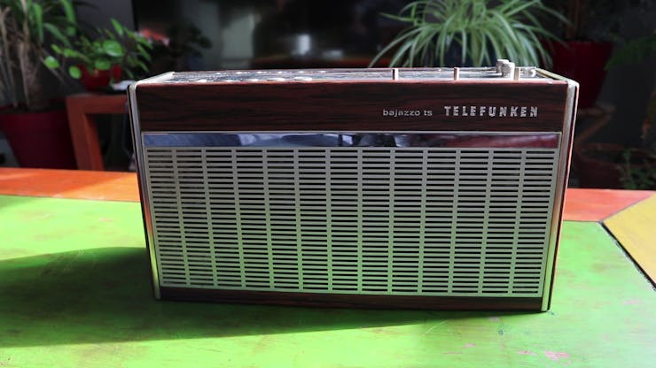

Like most retrofitting projects, this one starts with some old electronics, to be precise, a Bjazzo Ts by Telefunken, made sometime during the 1960's in West-Germany.image

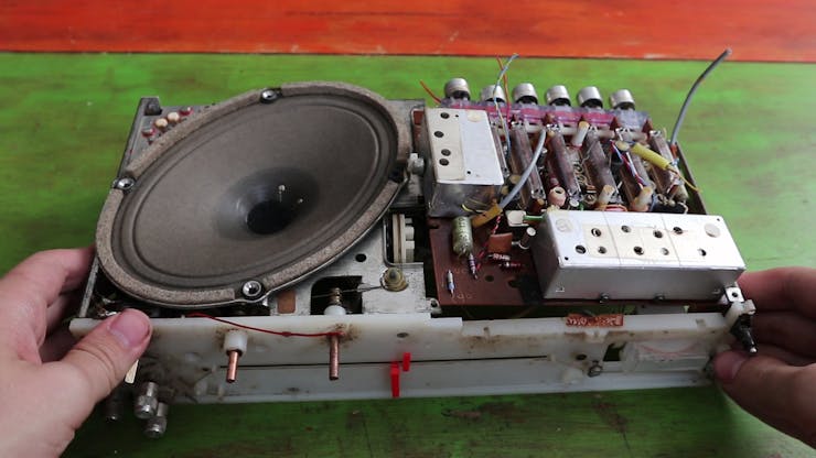

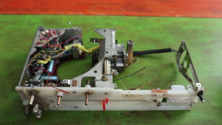

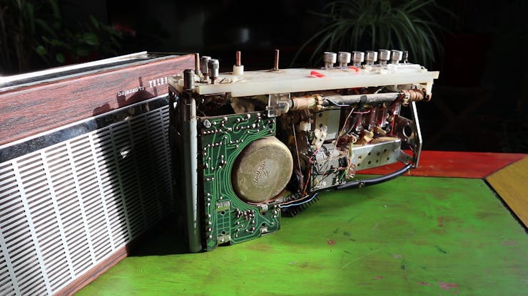

First up is determining what's reusable. The best way to find out is by disassembling our vintage tech. This step is different for every device, but removing all screws you encounter is a great startimage
Lucky us, we can salvage both the original speaker and the on/off button. We also keep the part that's holding up all the buttons.
After this successful operation we are left with some reusable components and a semi empty frame.

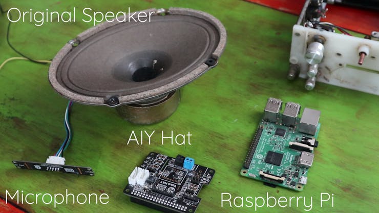

With our newly created space and reusable parts we move on to the next step, adding our own hardware.
The aim is to make a voice controllable, interactive, storytelling device. This means we need a microphone and speaker, combined with some sort of processing power. Que the Google AIY Voice Kit, a hardware package perfect for our endeavor.

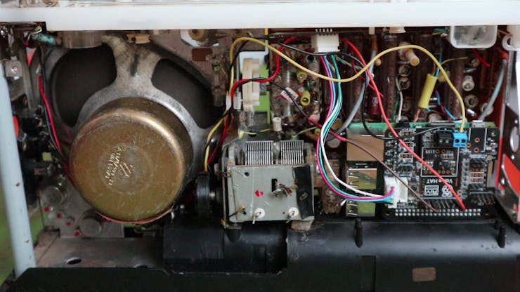

Following their build instructions is straightforward, but instead of the provided speaker and button, we connect the ones we recovered from our old radio. With all the hardware assembled and ready, we can now run any of the provided examples.

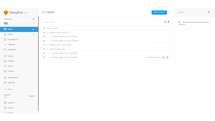

Chatbot

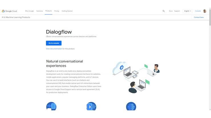

Success, with the story complete we can start on the chatbot.Ideally we'd have a piece of software that helps with picking the right response, both extracting meaning from the spoken text, and making the plot decisions.
This is is exactly what a chatbot platform provides, both detecting meaning in text ('Natural Language Processing') and making decisions.
There are many providers out there, and you can pick any of them, however, we picked Google Dialogflow because it's free and easy to use. Dialogflow has a great getting started guide right here.
After some setting up and creative writing the chatbot is ready to go. Now we connect the local hardware with the chatbot, transforming our invention into a true voicebot.
