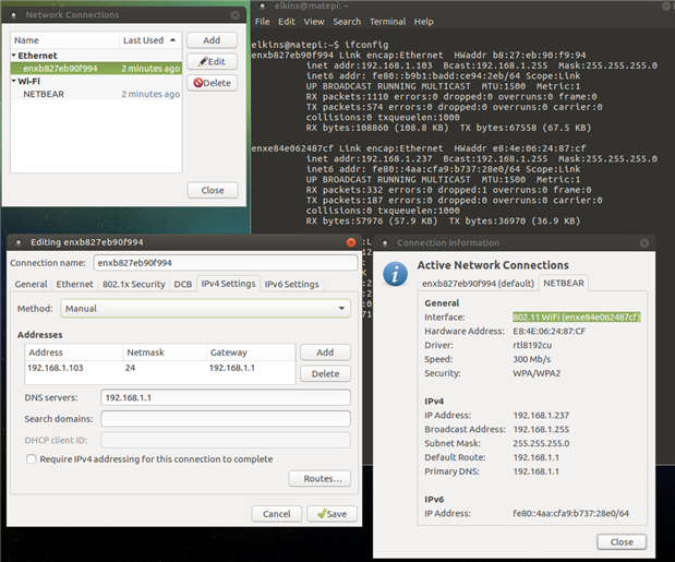

I decided for this WiFi connection, I'll leave it as DHCP (the default for all connections) but I really want a fixed IP address for the wired connection.  Note the following picture:
To edit the wired connection, I clicked on "Edit connections ..." in the Network Manager drop-down menu which got me the "Network Connection" box in the upper left of the picture.  I highlighted the wired name (shown there) and clicked on "Edit".  Note that the wired name changed.  It now has a name governed by the "Predictable Network Interface Names" scheme (https://www.freedesktop.org/wiki/Software/systemd/PredictableNetworkInterfaceNames/ ).  I wish that had happened from the get-go and I never saw the "Wired connection 1" label.  Well, nobody is perfect.  I hope that this does not confuse a novice.  Never edit "Wired connection 1".
In the lower left of the picture, you should find an "Editing ..." box with details that I entered for my wired static address:
  • Method: Manual
  • Addresses (only one)
    • Address 192.168.1.103
    • Netmask 24 (I could have entered the equivalent 255.255.255.0)
    • Gateway 192.168.1.1 (My router's IP address)
  • DNS servers (only one): 192.168.1.1 (My router = my DNS server)
and then I clicked on "Save".
Note that the Addresses component entry process is a bit brittle and has been complained about.  Enter the components this way:
  • Pi Address value
  • Press the Enter key
  • 24 (or whatever your netmask value should be)
  • Gateway address value
Do not use arrow keys.  If something goes wrong, start over.  I agree that brittleness has no excuses.
The result is the lower right hand box showing the NETBEAR tab and the `ifconfig` output in a terminal window behind the 3 boxes.  You should see that the wired connection has a static IP address and the WiFi connection is using the DHCP scheme.
That's it.  Not perfect but quite simple, quick, and has network configuration heading in a productive direction.
