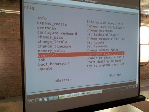

The Raspberry Pi Foundation released a new Raspbian SD card image yesterday with some interesting new features including dynamic overclocking.  I had the July Raspbian image on an SD card which I already setup with everything I need to do a demo, so I didn't really want to have to startover with a fresh image.  Therefore, I decided to give the upgrade process a try:

3) Finally I updated the raspi-config utiltiy so that I would have the new overclocking menu option.  To start the utility, type:
sudo raspi-config
Then select the Update option:
After the update is complete, you'll find a new menu option in raspi-config when running it again: overclocking!
There several different settings with the maximum called "Turbo"... which really begs for a pushbutton to be added like back in the 486 days image
I selected Turbo and then allowed raspi-config to reboot the system.
