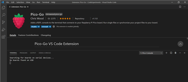

The Pico Pi defaults to being a USB Serial device. So should appear on your machine as a COM port. So for this reason some kind of tool is needed to copy the files to the board. I used the Pico-Go extension for VSCode but the Pymakr extension should also work. These provide buttons on the status bar at the bottom of the screen to upload and run the code. You can also get more options from the menus such as deleting all the files on the board or downloading the board content. Note that these work at a project level so will upload all of the files in the working folder including subfolders. The extension also gives you access to the REPL via a terminal window.

    Glad I read this article.
    I had originally found the Pymakr extension on VSCode and thought to give it a go but it did not work straight out the box. Looks like you have to tweak the global settings to get the Pymakr terminal to connect to the Pico board. So I've now uninstalled Pymakr and switched to Pico-Go and this connected without bother.
    According to VSCode marketplace, Pico-Go originally was a derivative product of Pymakr but it has now received significant rewrites.
    I see there is some good docs to read through too at: Quick Start - Pico-Go
    Just to add... as quick start guides go, this Pico-Go guide is very good.
