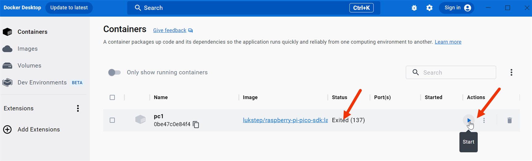

Note that if you ever shut down your PC, then you need to start up the container in a different way (the command in the section above both installed and started up the container, but after a reboot, you only need to start the container, without re-installing it). If you ever restart your PC, if you're using Linux, then type the following to start up and access the container:
docker start pc1
docker exec -it pc1 /bin/sh

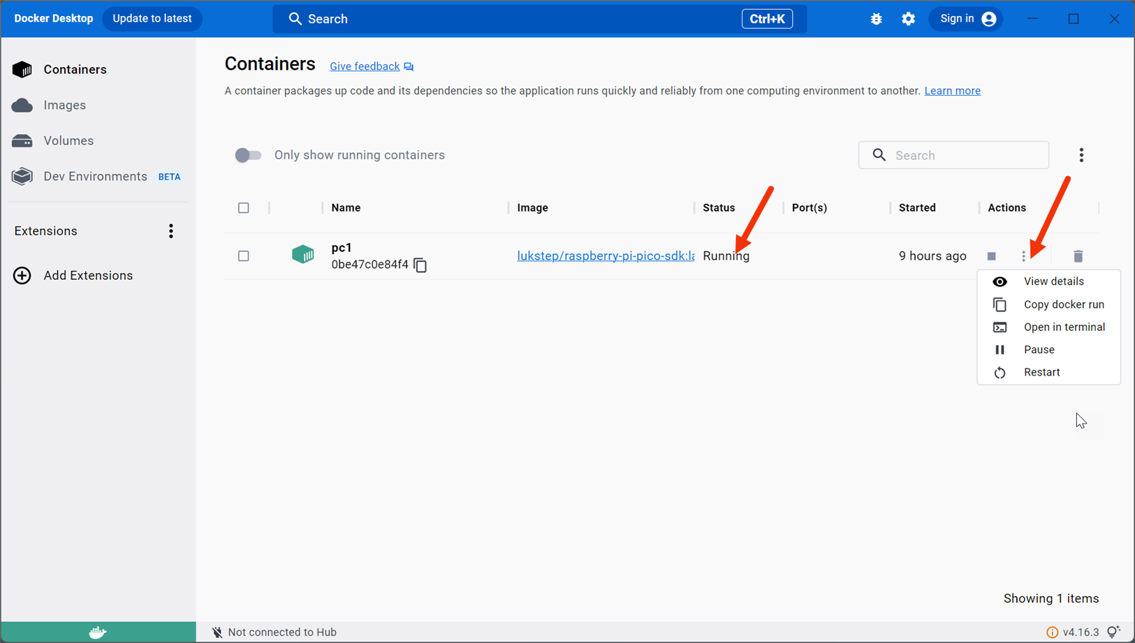

If you're using Docker Desktop, then ensure Docker Desktop is running (from the Windows Start Menu or Mac equivalent menu), and you can start up the container by clicking on the triangular play icon next to the container, as shown in the screenshot below, and then the Status will change to Running. Then, you can type docker exec -it pc1 /bin/sh in a PowerShell to get inside a shell in the container.

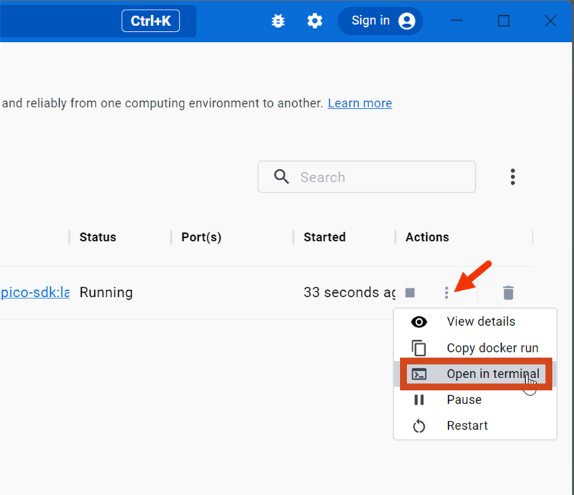

Incidentally, if desired, Docker Desktop users can directly enter the container (without using PowerShell) by clicking as shown in the screenshot below:
For Docker Connect users, if you ever see a message "error during connect" or "This error may indicate that the docker daemon is not running" then that means that Docker Desktop is not running, and you will need to run it from the Windows Start Menu. If you see the message "Error response from daemon: Container xxxxxxxxxxxxxxx is not running" then that means you need to click on the triangular play icon.

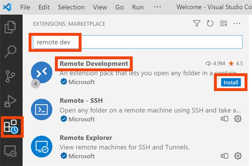

    For those using Docker Desktop, Visual Studio Code (VS Code) connects to it, so that the code can be edited and built within VS Code.
    First make sure in Docker Desktop that the container is running, and if not, start it up.
    In VS Code, click on the Extensions icon on the left (the square blocks icon) and type remote development and install:

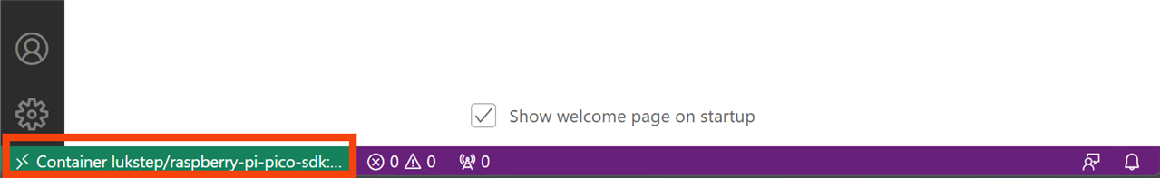

    Now you can go to View->Command Palette (or type Ctrl-Shift-P on Windows at least) and type attach, and select Attach to Running Container:
    You'll see the name of the container, and you can click it.
    After a short while, the bottom of the VS Code window will show in green that it's connected:
    Now select the folders icon on the left side, and click on Open Folder. In the box that appears, type the desired path to open, for instance /home/dev/ or /home/dev/pico if you've created the pico folder in the container before.
    And this is what it all looks like. Access to the terminal (shell) is achieved by clicking on the text TERMINAL as shown in the green box, and the commands can be typed there to build the code.
    After the code is built by typing commands in that terminal window, then the .uf2 file can be transferred to the PC by navigating to it in the file view in the left pane,  then right-click on the file and select Download.

    shabaz over 2 years ago in reply to fmilburn
    Ah.. I just read your error message. I now understand.
    That message "docker: error during connect: this error may indicate that the docker daemon is not running" indicates that Docker Desktop is exited, or not started. (Maybe your computer went to sleep and it exited, although I thought it shouldn't). Once you start up Docker Desktop (i.e. from Windows Start menu) then that error won't occur.
    On the other hand, if you ever get a message beginning "Error response from daemon" then that's a sign that the Docker Desktop just needs to be checked to see that the container is started up, i.e. check the state of the container in the Docker Desktop window. If it's not in Running state, then the triangle Play icon can be clicked as shown below:
    Then, the docker exec -it pc1 /bin/sh command will work in a PowerShell, to get you inside the container.
    Incidentally, if you wish, you could directly go inside the container like this:
    That's the same as typing that docker exec -it pc1 /bin/sh command.
