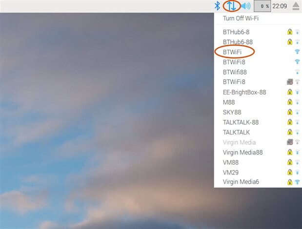

The Pi has an Ethernet connection but the recent Pi 3 also has built-in wireless capability. If desired, the wireless can be enabled and the Pi can be disconnected from the Ethernet.
There are several ways to enable and configure the wireless. If you’re using the graphical user interface then the easiest way is to go to the top-right of the screen and click on the wireless connections icon and then click on your wireless network identifier (SSID).

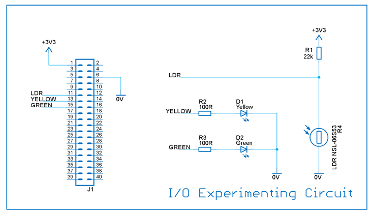

Connecting Input/Output (I/O) Devices to the Expansion Header

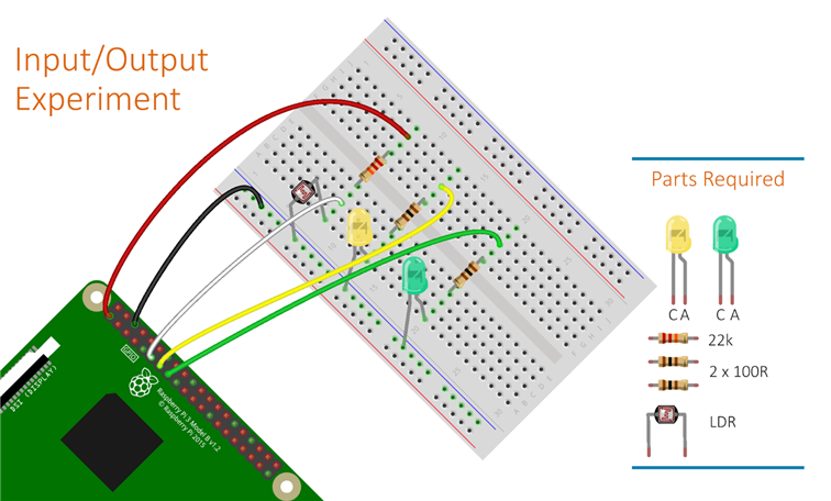

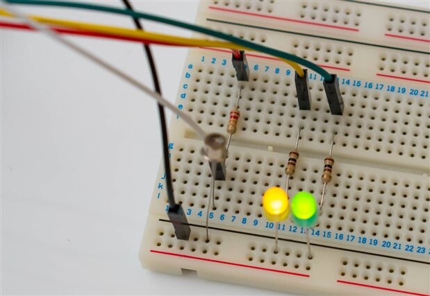

The Pi has a dual-in-line (DIL) pin header that can be used for connecting up external devices. When creating projects with the Pi one isn’t constrained to sound and video. Attached external hardware can be controlled and monitored too and the expansion header (also known as the GPIO or general purpose I/O connector) provides one way to do that.
This blog post isn’t going to go into much hardware detail, except to suggest that a small amount of hardware is useful to be available to attach to the Pi to experiment in this area. It can be as basic as a single LED and a single push-button switch. An LED could be used to simulate a motor for example; when the LED is lit then the motor may turn.
The photo here shows an example setup that could be useful for testing things without needing expensive hardware, high power motors and so on. Here three devices are connected to the Pi; one input device which is a light dependent resistor (LDR), and two output devices which are green and yellow LEDs.
It is possible to write some simple code that will turn on the LEDs when the light dependent resistor determines that it is dark. It could be a simulation of an automatic light outside a building.
If you want to build the circuit the parts required are:
Light dependent resistorLight dependent resistor
Yellow LEDYellow LED
Green LEDGreen LED
22k Resistor22k Resistor
100R Resistor100R Resistor (two required)
Male-Female Jumper WiresMale-Female Jumper Wires
BreadboardBreadboard
The LEDs need correct orientation; the cathode (C) is always the wire closest to the flattened side of round 5mm LEDs, and is almost always the shorter wire if the wires are of different length. There is no harm if the LED is accidentally reversed in this circuit, the LED just won't light up until it is correctly fitted.

 * iotest
 * revision 1 shabaz June 2017
 * Header pin 13 is GPIO27 and is connected to a yellow LED
 * Header pin 15 is GPIO22 and is connected to a green LED
 * Header pin 11 is GPIO17 and is connected to a light dependent resistor
// includes
#include  <stdio.h>
#include  <wiringPi.h>
// definitions
#define YELLOW_PIN 27
#define GREEN_PIN  22
#define LIGHT_PIN 17
#define FOREVER 1
#define BRIGHT 0
#define DIM 1
#define LED_ON 1
#define LED_OFF 0
 * main program
int
main(void)
  // define the inputs and outputs
  wiringPiSetupGpio();
  pinMode(LIGHT_PIN, INPUT);
  pinMode(YELLOW_PIN, OUTPUT);
  pinMode(GREEN_PIN, OUTPUT);
  while(FOREVER) // do everything here in loop forever
    if (digitalRead(LIGHT_PIN)==BRIGHT) // is it bright?
      digitalWrite(YELLOW_PIN, LED_OFF); // turn the lights off
      digitalWrite(GREEN_PIN, LED_OFF);
    else // otherwise it must be dark..
      digitalWrite(YELLOW_PIN, LED_ON); // turn the lights on
      digitalWrite(GREEN_PIN, LED_ON);
    delay(100); // wait 100milliseconds and then loop back
  // the next line never executes
  return(0); // warning on this line is ok
Some of the lines of the computer program might not make much sense to a complete beginner but by the definitions section (from line 16) it becomes clear that this is a bit like algebra, assigning numbers to characters or names. Then it can be seen that the code is declaring some of these names to be outputs, and one of them to be an input.
The next bit (from row 43) looks a lot like a flow chart with diamond-shaped decision block, where the code is instructing the computer to check if the external hardware connected to the input pin is indicating a bright situation or a dim situation and set the lights (LEDs) on or off accordingly.

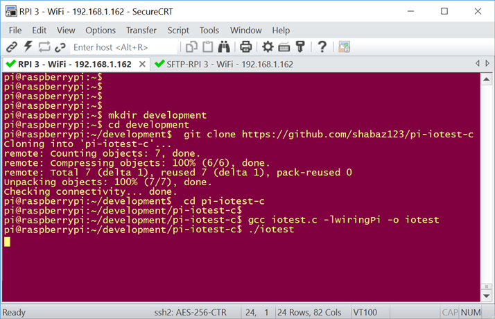

More detail and more interesting stuff is the subject for a different blog post, but in the meanwhile the program can be executed by doing the following steps:
Firstly save the code to a file on the Pi, called (say) iotest.c - a quick way to do this rather than copy-paste is to just grab the code from an online repository where the code has been placed already.
The steps in the screenshot below create a folder called development, and then inside that folder the file from the repository is copied across into a sub-folder called pi-iotest-c. Then inside that folder the program called gcc is executed. It converts the human-readable code into instructions that the computer understands natively. The final line runs the program. Placing the hand over the sensor will make the LEDs light up. To quit the program at any time, press Ctrl-C (i.e. hold down the ctrl button and then press C while ctrl is still held down).

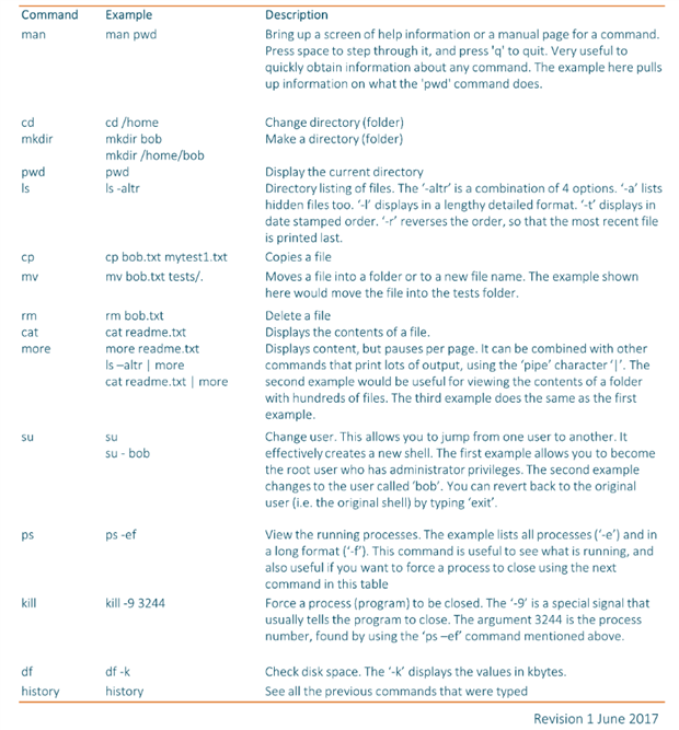

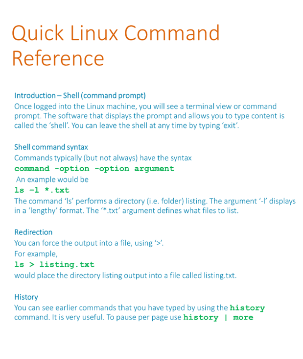

Quick Linux Reference Guide
Linux has lots of useful commands, some of the most useful ones are listed here as a 1-page reference. For a beginner it could be useful to print this out and keep it handy, or bookmark this web page. It is also available as a PDF attached to this blog post.
