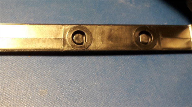

Is there a way to add an external wifi antenna to the smartedge box? I need to mount it in an electrical cabinet and route an antenna out of the box.
    Jan Cumps over 5 years ago
    For the SmartEdge IIOT Gateway?
    It is possible. There is an extra plastic part that you put between lid and housing. It has a breakout position for an external antenna.

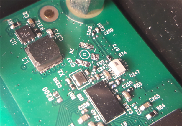

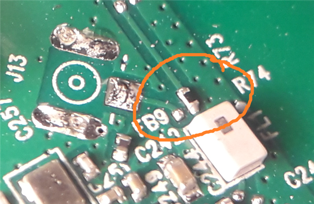

    You'll need to solder a SMD little connector on the PCB. The footprint is empty.
    I could not find if you have to add/remove components to switch from PCB antenna to the external.
    Jan Cumps over 5 years ago in reply to Jan Cumps
    Here's the additional plastic edge, with the breakouts:
    The PCB:
    My guess is that you switch by flipping this component 90° counterclockwise:
