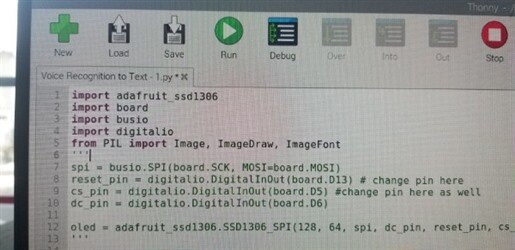

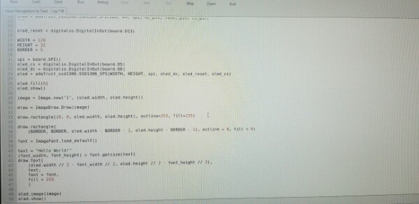

Secondly, I was trying to set up and test the display that I got, and I used the example code on this website. I am pretty sure I copied it correctly, I couldn't copy and paste because the raspberry pi is very... very slow(again, if you have any tips for speeding up te workflow would help a bunch.) but here is what I wrote (beforehand, I installed the adafruit blinka module, the SSD1306 library, and the PIL module. Did I miss anything?):
The code runs but the display doesn't actually display anything, it's just black. Does anyone know how I can fix that?

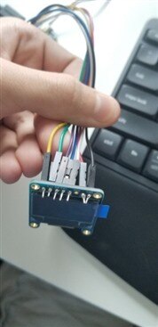

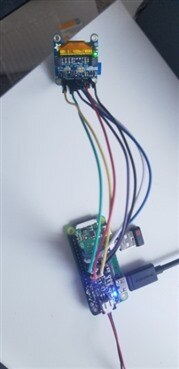

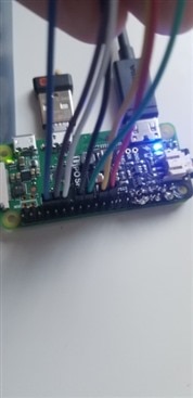

Here is the wiring, maybe that is the reason (so sorry for my horrible soldering)
I followed this guide on this - bottom of the page, I just used a different GPIO slot for one of the cables (reset pin - GPIO slot 13)

    Looking at your picture of the board with the blue tab sticking out the right side with the 7 dupont leads going in are they soldered?  It looks like the last two are joined - is this the case, or just how you are holding it - they should not be touching each other?
    Next thing, check the pins assigned in your code and double check you have them correctly connected on the board.  Your other pictures are too blurry to tell if you've connected the right PI pins to the right display pins.  You need to double and triple check those because to me it doesn't look like you've connected them to the PI correctly - I can't tell and I'm not sure.
    Here is a pin out for the Raspberry Pi Zero W - check the first answer with a pic.
    Your OLED board is connected like this from what I can tell:
    Yellow -> Pin 1 -> CS -> D5 in the code
    Green -> Pin 2 -> Reset -> D13 in the code
    Purple -> Pin 3 -> DC -> D6 in the code
    Blue    -> Pin 4 -> Clock
    White -> Pin 5 -> Data
    [empty] -> Pin 6 -> Vin (not needed)
    Orange -> Pin 7 -> 3.3V
    Black -> Pin 8 -> Ground
    As an example, in your photo it "looks" like the blue wire, which is CLOCK, is connected to the Pi GPIO13 pin which your code says is RESET.  Yellow, which is CS, looks like it is connected to GPIO10/MOSI when your code says it should be GPIO5 (D5) which is the 6th pin in from the left.
    Clearer photos might help.  Also, please beware that I've never used a Raspberry Pi Zero or that OLED board: I'm going to assume that D5 means GPIO5; D6 means GPIO6 and D13 means GPIO13.  Someone will correct me if I'm wrong!!

    I actually do have reset, I had a very rookie mistake, I did not cut the J1 and J2 traces on the back and that is why it didn't work. Thank you so much for your reply though!

    Thank you so much for your reply! I am very thankful that someone helped me out. The problem was actually that there are 2 traces on the back of the board that I had to cut in order to see SPI and not I2C, so that is why it wasn't working. I'm still very thankful that you tried to help me!

    Jan Cumps over 5 years ago in reply to mrmrag
    Fillip, now that we have your attention image: I think it's best to clip off the pins on the solder side. To prevent shortcuts later.
    And maybe retouch the one but last to the right on your first photo with flux or fresh solder. That looks like a cold joint.
