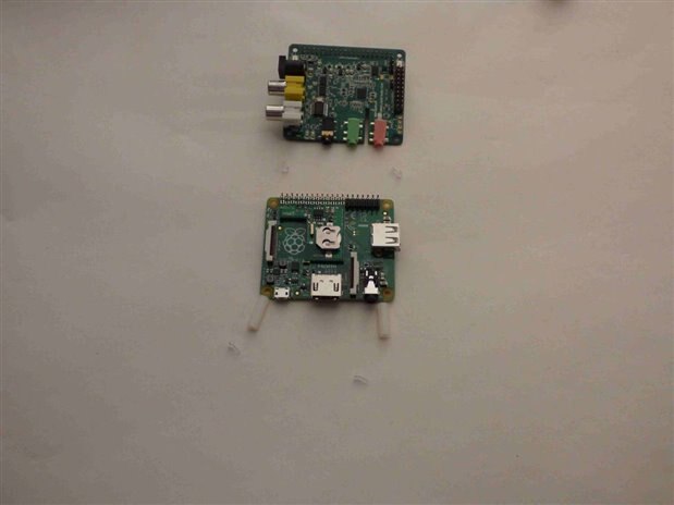

Images for fun:
First is the bare recorder.
Second is the B+ with piface shim RTC ready for CLAC installation.

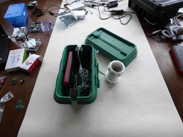

Third is the unit in waterproof box, ready to deploy (this is an older version using USB microphone - so no cirrus card on this one).

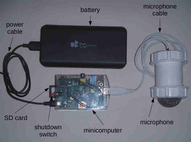

Fourth is another of the old-fashioned USB mics  - this time the anatomy.  Note: I've given up on the power-off switch - nobody used it.

    Kudos on having solved all the mechanical issues too - mine ended up stuck on the bench, because I wanted to record in stereo so had to amp up the mics to run line in and do the electret powering, and I couldn't see how to keep the water out.
    Where do you get those waterproof boxes from, I have box envy...

    jcjc over 10 years ago in reply to e14 Contributor
    Richard,
    The boxes I used are from "dribox".  There are three sizes, and the smallest (costing 8 UK Pounds) is enough for all the electronics and a big usb powerbank.
    They were are _real_ delight to find, as I'd been hunting and hunting for something like this.
    JC.
