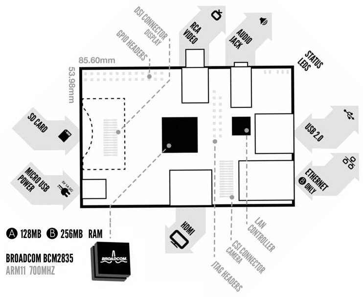

While I'm more interested in Android, for either, I think way to interface a touchscreen would be needed.  I see that there is a DSI display connector shown on the diagram:
I'm not familiar with that interface, so I'll have to look into it.  I'm hoping that would allow for a touchscreen to be connected.  Anyone else know more about the DSI interface?

    I have only used a DSI for simple displays like 7-seg and character LCDs.
    I think a more fully featured touchscreen might work best via USB.
    Personally, I would just want to use a touchscreen, or touchpad, as a input device.

    There are USB touchscreens which should work with the Raspberry Pi - check out lilliput or mimo touch screens with usb interface.
    Might take a bit of messing about to get drivers working.

    Ah, good point.  I keep thinking like a microcontroller.  Yeah, I suppose USB makes sense given that there is a kernel which could support drivers for such devices.

    Interesting, I hadn't heard of Surface Acoustic Wave touchscreens before.  I'll have to look up that technology.  This does look promising though as it has a driver for several different Linux distros.
