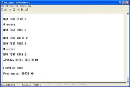

    As promised, very quick test on 32Gb Class 10 card (Samsung 32Gb Micro SD, HC) from Amazon.
    Tested with ST ARM CortexM4 (STM32F407....) fixed 3.3V interface and power.
    Software Keil ARM RTX and RL-FlashFS using ST driver for the SD card (in 4 wire native mode)
    I didn't have time for serious speed tests but the boot up on this system works OK:
    The same card works OK with a Windows PC using a £1.90 USB <-> SD card adaptor, Windows reports 29.2 Gb free.
    Not much of a test but I don't think fixed 3.3V should be  a problem.
    (It would be nice to be more definite about this but the full SD specification can only be obtained by paying serious money to join the SD card association and the publicly released simplified spec. is short on detail in this area - however it does not look as if 1.8V signalling is required by Class 10 cards.)
