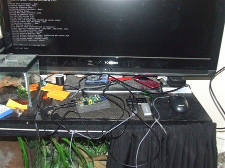

    I was doing this originally with my Pi.
    I found that even with a pretty dumb/cheap powered USB hub, there was still a good amount of voltage drop when measuring the TP1 and TP2 points.  I found that the tracks inside the hub were generally not heavy enough to carry more than 500mA and I was often seeing around 4.7v even though I had a decent 5v 3A PSU supplying the hub.  I eventually opted for creating my own Y cables (to power the hub and Pi from the same PSU) and that seems to give me the best voltage across TP1 and TP2 as I now get around 4.89v using a Y lead with the same PSU.

    I went through 5 different chargers that had a USB socket, all capable of 1A or more, and they all failed to provide enough volts.
    The cord drop was measured and sure different cords varied slightly.
    Even a genuine charger for a smartphone with a micro usb plug didn't provide enough.
    I suspect that most phone batteies now are 3.6v, so it doesn't really matter if its 5v or not.
    In the end I used a 1A charger made by Brightlink and distributed by Brightpoint.com thru The Warehouse (here in NZ and AUS)

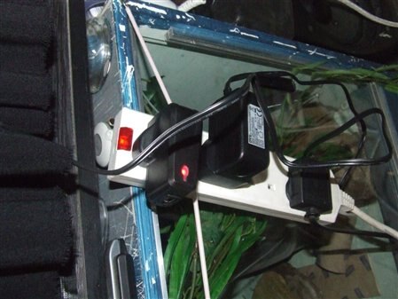

    So far have tried a generic one that I had already- not too much use,
    Ordered (and in the process of returning) one from Amazon which was sold as a 5V 2A charger..... nice, however, it arrived this morning and it RATTLES (many hours of fun for small children but not a wanted feature for a PSU)
    Current thoughts are some sort of 5V mains charger, or running it off of the 300W ATX powersupply that I already have stripped down to being a bench supply- nice stable 5V but it is a little large for me to be perminantly happy with that as a solution.
