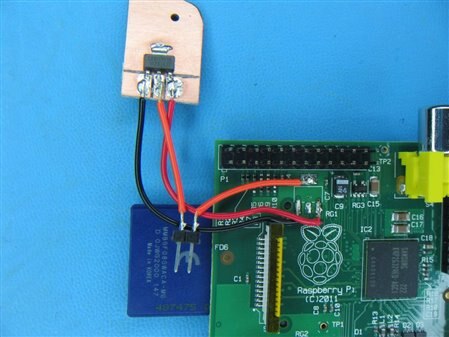

Ok, so in a different thread I threatened to remove RG1 and do some current measurements on it's output after seeing those thermal images that show it's not generating any heat...
Well, I did it tonight. Some photos here: https://picasaweb.google.com/selsinork/RPi18v
The jumper pins in the output let me either just put a jumper on and verify the Pi boots ok, or wire a multimeter in series to get some current readings.
The results were interesting to say the least. I had to go back and check I was reading the multimeter correctly, that it wasn't broken etc.
On initial power up I see a negative current for a second or so which then reverses to about 0.5mA (yes half a milliamp, that's not a typo) for a few seconds while we get the first sd-card accesses. Once we're booted and sitting at the login prompt the current reading fluctuates from around 0.001mA to maybe 0.04mA.
I'm using the 40mA range on a decent Fluke multimeter, so I've no reason to doubt the results. There's obviously going to be some inaccuracy down at that level due to length of meter leads etc, but the result is fairly clear.  You'll understand why I was checking the meter was working and I was reading it correctly though image
So from there onto the next test, lets try completely disconnecting RG1 and see if the Pi boots while using the LAN9512 1.8v 'output'.  Yes it does!
I think that's reasonably good indication that jamodio got it spot on, the lan9512 shouldn't be connected to the 1.8v plane and it's heat problems are going to be largely due to supplying current on it's 1.8v filter pin that it was never designed to do.
So anyone willing to pull RG1 off a Pi and verify my results ?

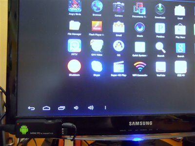

    BTW I'm playing with the MK802 and the thing works out of the box with Android 4.0, no issues with the RF keyboard/touchpad, video and audio are great, yes I paid $72 for it but includes a power supply, HDMI cable, USB cable, USB adaptor, comes with a nice box and btw has a case !!, ohh and 1GB RAM, 4GB FLASH, the Cortex-A8 runs at 1GHz and the GPU at 500MHz. With all that now the R-pi feels more expensive ...
    I've the little Gizmo attached to one of the corners of my monitor.
    I'll try some time later to get Ubuntu running on it
    -J
  • morgaine
    morgaine over 14 years ago in reply to jamodio
    Cute, thanks for the pic. image
