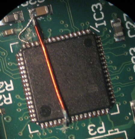

    I couldn't resist a little hardware hacking on a Saturday morning.
    My LAN9512 isn't running hot, only luke warm I would say, but I can guarantee a system hang by copying a file from an nfs mount to a usb flash drive in 10-20 seconds. USB keyboard is a little glitchy too. Tried 10W iPad charger and Dell monitor with integrated USB hub for power also without keyboard over ssh. That's motivation enough for me to tinker.
    Carefully, I cut the circuit traces from pins 15 and 38 on LAN9512 and the 1.8V side of C29 to the vias. I then very carefully soldered some wire between these three points. This more closely resembles how the circuit should be (minus the 100nF caps). (The 9512 reference design says 4u7 should be by pin 38 btw) See photo:
    Measurements taken before show 1804mV on both RG1 and C29. After modification I have 1797mV on RG1 and 1809mV on C29, so I am confident the regulators are now isolated. The effectiveness of my filter circuit is a little more dubious.
    Didn't fix the system hang copying over LAN to USB, but I can copy from LAN to the SD card (didn't think to test that previously). At least my Pi still works.
    Now that VDD18CORE is isolated from RG1 I can measure the current drain on RG1. More results to follow.

    are you able to measure the temperature of the lan9512 with this mod in place?   I'm only getting arount 48C on any of thr Pi I have, which I don't consider too bad, certainly not the 'blisteringly hot' others have reported..  So either I have asbestos fingertips from too many years of burning them with soldering irons, or there's some other factor involved.
    Ideally we need to find one that runs hot, or how to duplicate that condition, and try this mod on it to see what difference it can make.
