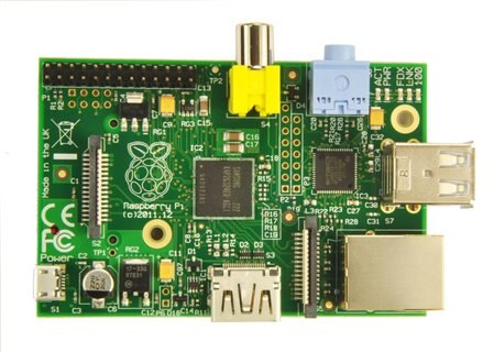

Eben has a front-page story up explaining rev 2.0.
It does fix the 1.8V problem, although no credit where
credit is due to Jamodio or any of the others here for
finding, characterizing, and reporting the problem.
No mention that I can see of FCC/CE residential
certification.  I assume the needed minor pcb changes
were made, but perhaps certification has not been
done yet.
http://www.raspberrypi.org/archives/1929
p.s.
   hopefully element14 will explain to their customers
how to be sure to get rev 2.0 when ordering.

    It is really a great thing that they already released the schematics and gerbers for the new board !!

    I noticed immediately that there are three "cpuinfo" codes reserved for RasPi 2.0: 4, 5, and 6.  The obvious guess is that they're for Model B 2.0, Model A, and Model B w/ 512MB.
    Maybe they already found another issue, so the codes are for Model B 2.0, Model B 2.1, Model A 2.1. image
    The PoP RAM is mobile LPDDR2 400MHz 1.2V in an FBGA168 package, 32bits wide.  Digikey prices for 1000 quantity are $15.20 for 256MiB, $24.48 for 512MiB.  (And $36.72 for 1GiB, but we think the SoC does not support that.  They do not even sell 128MiB any more.)
    Those prices are not tremendously meaningful, because nobody would buy this stuff from digikey, and it is not even a stocked item.  But it does seem very likely that a Model B+512 could be made for $50.  Whether the RPF would want to do it is another matter.  There is a risk of future software requiring the extra memory and failing to run on the hundreds of thousands of units already sold.  (It would be good for their rivalry with BeagleBoard/TI, though.)
