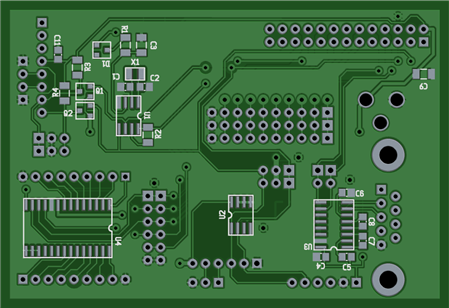

    Sadly I've been busy with other things and really haven't had the time to do too much with my Pi recently. Currently mulling over whether I need to redesign some of my hardware add-ons due to the v2.
    Here's a quick teaser of one of my designs:
