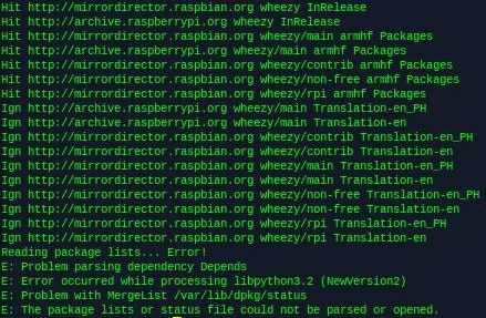

Hello everybody! After successfully updating my SDHC card containing Arch Linux ARM, I decided to update my Raspbian SDHC card. Shockingly, I got the error as shown above. The command I used, was:
  • sudo apt-get update
The Good News
Luckily, I am able to fix it... Here's what I did:
  1. sudo su -
  2. cd /var/lib/dkpg
  3. mv status status-bak
  4. cp status-old status
  5. exit
Next, I reissued the command apt-get update and it appears to be fixed, and so I continued:
  1. sudo apt-get upgrade
  2. sudo apt-get dist-upgrade
Now, everything appears to be working, again! image
