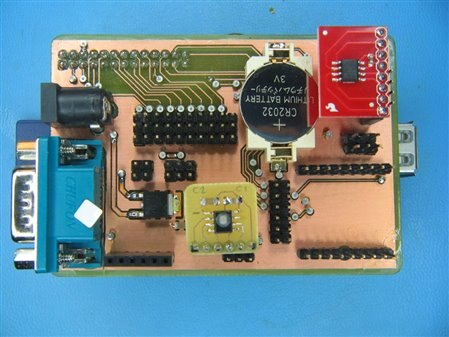

I've been a bit quiet on the R-Pi front for a while, so I thought some of you might enjoy a quick look at what I've been up to.
There's some more at https://picasaweb.google.com/selsinork/RaspberryPiModifications
So any guesses what I've been building ?

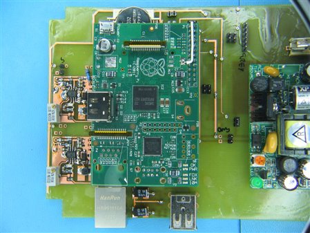

    This isn't really a guess, because I've been watching your comments for a long time, but it's nice to see the PCBs.  Top board looks like you've replaced the now-missing 3.3V and 1.8V linear regulators with switchers.   How's the 5V power consumption?  Bottom board looks like RTC and RS-232 (and/or RS-485), along with a decent power jack.
    How do you make your PC boards?  Top one looks like flexible PCB laminated onto a solid board.
    e14 Contributor over 13 years ago in reply to johnbeetem
    pcbs are just standard uv exposure then etched, what makes that top one look rather odd is that I tend to coat them with fluxflux which I find dries hard enough to give the board a reasonable amount of protection from oxidisation and the like while making soldering much easier. Something didn't go quite right with that board though, the flux is rather patchy, some areas are bare and others have very thick deposits.
    the switchers are based on the TPS54231 that jamodio suggested on here way back this time last year. Simplistic measurements show them to be just under 90% efficient and the overall temperature of the Pi has dropped noticeably.  As you can probably guess I'm intending to adjust the 1.8v up just enough that the lan9512 isn't the source of 1.8v for everything else.
    Haven't looked at 5v consumption yet, was going to do that the other day and then realised that I didn't leave myself a convenient place to tap into for a current measurement. So I'll need to remove the main psu from the board to get some measurements. Prototypes are such fun.. there's always something you forgot that will require version 2.0 image
    Anyway, after some initial buglets (flux makes it easy to put shorts on the board too!) it's running with thisthis small 4W supply quite happily instead of the much larger one in the photo. I put footprints on the board for three different psu's, hoping the small one would be ok, but giving myself an upgrade path to a 10W or 15W supply if necessary. A short behind a cap at the usb power switch led to some initial odd behaviour and a change to the bigger supply, which promptly fried the cap and let me find the short!
    Both boards have essentially the same MCP79410 RTC, which with a little platform data means the clock gets automagically set on boot by the kernel, no messing with modules or hwclock here.
    Top board also has a proper usb power switch, sadly that'll only work for a v1 Pi as the easy access to the connections on the lan9512 have been removed on the v2. You could do it on a v2 with some fiddly soldering direct to the pins of the lan9512, but I'm not sure if I can be bothered with that.
    bottom board has the sensible power connector, rs232, pi-face compatible mcp23s17 gpio expander, RTC, temperature sensor and connection points for some sparkfun breakouts including humiity and barometric pressure sensors, then level shifting for some 5v I2C stuff to be connected.
    In the bigger picture, this was one of the goals:

    Next challenge is getting it into a case...

    seriously though, I was after something that I can get to 'appliance' level, i.e plug it into power and network and it just works.. and needs to sit in it's box and keep working indefinately. So a lot of stuff simply isn't required, having a go at fixing some of the problems along the way comes with the territory.
    The Pi makes a surprisingly neat little plug-in module once you start down the path I've taken here.  More to come and I'll try to get a blog post up for these two soon.
