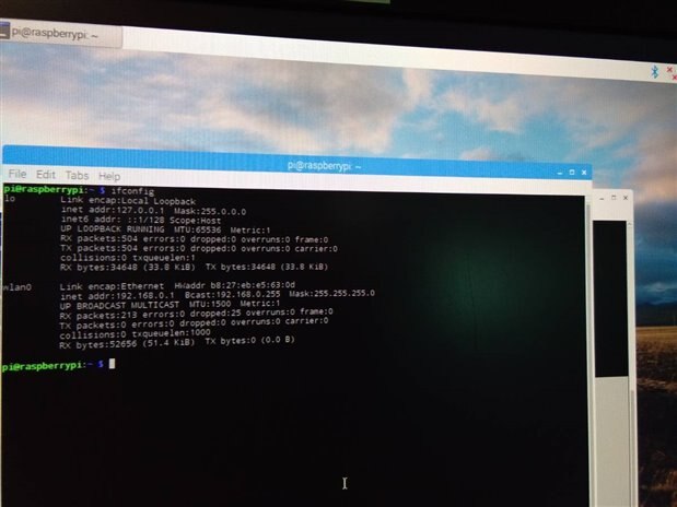

    ktjr over 9 years ago in reply to e14 Contributor
    I could not see eth0. and it is disabled since yesterday only before it was connected. How to enable this. Please help resolve this issue. Thanks in advance
