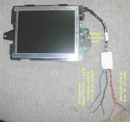

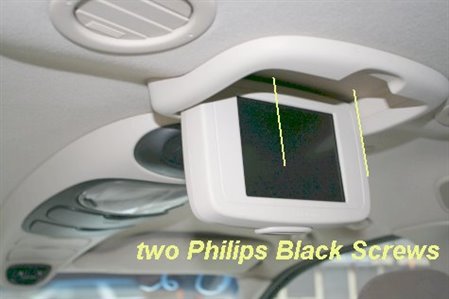

With the removal of just two phillips screws, the entire asembly drops down revealing just five wire connection
from any Ford Winstar/Freestar type vehicle although I noticed the feature in the WinStar Vans from 2000-2003 which are
now appearing in great quantities at these Auto-graveyards.
Only 5 wires of 20AWG stranded are in the harness!
Red = +12,
Black = Return,
Silvered = Signal Ground,
GREEN = NTSC 1V Video composite Input,
Blue: assumed to be a diming input with Headlamps active, but grounded to the Silvered connection.

I used the Red/Black for power,
Green for composite video,
and spliced the Blue/clear/Black shield for video ground.

AutoVision shown in its case, with ceiling cavity removed:

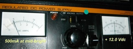

DC power supply detail from the bench
12V power (from around 8.3 up to 16.0 but I wont go higher than that)
Brightness Pot was set at about 50%
down to 0 = about 250mA @ 12.0V
up to MAX bright = 730mA @ 12.0V

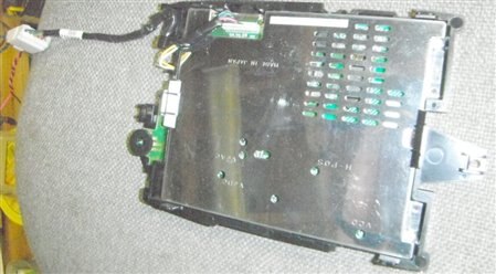

the second module stripped naked (!electronics porn!) of its shell
showing 5 wire harness ruthlessly ripped from the dead Luxury Van,
wires tortured and cut with a dull flat blade screwdriver
[yes I forgot my side cutters and the FORD section was some 1/2mile into the compound]
face side up on the Sharp LCD

and you are looking for this display on the rear seat roof facing rearwards
(5) Undo two cross-philips screws, pull down from rear, cut 5wires past harness connector

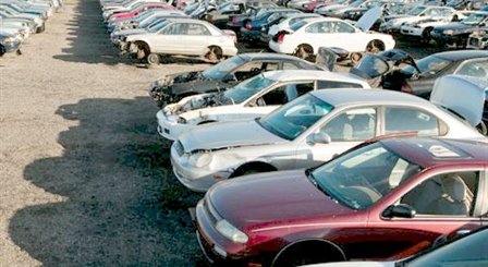

Photo example of the U-pull yard I like to go to (showing Imports section I think) ;
Cars are propped up on old rims; sharps bits and broken glass everywhere,
take care please, use appropriate foot , eye, and hand protection.
