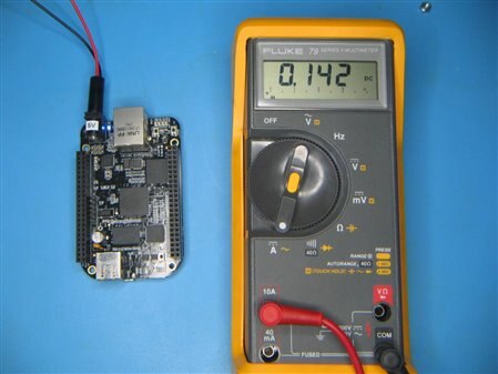

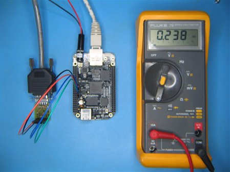

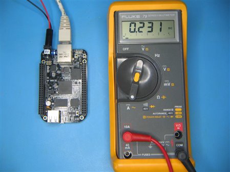

    Gary Stewart wrote:
    It is not clear from your description, were you using the BB Black as stand alone (using HDMI video) or tethered to a PC (not using HDMI video) ? If you were not that
    would explain some of the difference.
    I was quite clear about what I had plugged in. Specifically so that others could duplicate the test.  Yes there will be differences, but unless both you and I have exactly the same things plugged it then the numbers can't be compared anyway. Although the SRM gives some general idea of what was connected there isn't enough detail - was their usb hub powered or not, what was the precise make and model of the thumbdrive etc.
    So, for avoidance of doubt, here's some photos of what's connected along with the current reading. this is with the default angstrom build which uses the ondemand cpufreq scaling

    There are substantial differences in your test set up and theirs so differences in current readings are to be expected. A couple of these differences stand
    out. Since they did not specifically say the hub was powered I assume it was not. And it makes more sense that for power testing purposes to not power
    the hub externally. They stated that the HDMI was connected so I assume the GPU was in use. Between the two port hub, the thumb drive and the GPU
    I'd be surprised if that didn't account for most if not all of the differences you are seeing.
