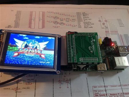

    There is new stuff continuing to become available too, like this:
    Here, the CPLD converts framebuffer output arriving on SPI into a parallel form suitable for writing to the LCD and activates the chip select and write signals as required. The frame buffer drivers are Notro's excellent work here:
    https://github.com/notro/fbtft
    and the megadrive simulator came from here:
    http://sourceforge.net/p/dgen/dgen/ci/master/tree/
    Sonic of course came from Sega Inc. Sonic may not be educational in itself, but if it entices even one youngster to start playing with programmable logic it's done its job.
    In case anyone is wondering, I own not one, but 3 original copies of Sonic the Hedgehog. Please do not download games you do not own (and please don't ask me where to find them, I will ignore your message*). Gameplay is smooth, sound is surprisingly good too.
    * I should add that this is the only kind of message I will ignore. Any other questions are encouraged and will be most enthusiastically answered. :-)

    wow that so cool i never knew that you could even do that with the pi

    Yup, with a little extra hardware.
    In fact, you can do this without a Guzunty. It is possible to do it using discrete logic (a ripple counter and two shift registers), but I think it is cooler to use the CPLD, since you don't need a breadboard.
    The LCD is only $15 plus shipping (and so is the Guzunty for that matter).
