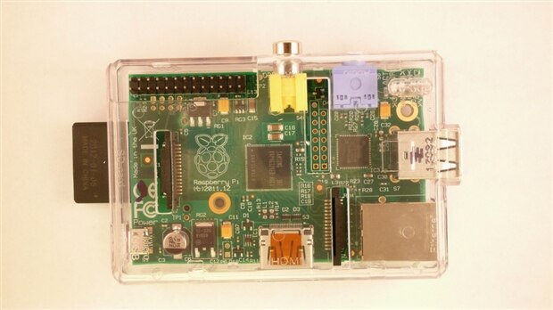

This is a picture of the Pi Tin with a Raspberry Pi in it.  You can see the I/O connector in the upper left which is exposed.

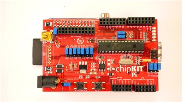

This picture shows the chipKITTm Pi plugged into the Raspberry Pi.
I went through the getting started document on Element 14.  After I finished with that my Raspberry Pi booted and had the chipKIT IDE on the desktop.  I opened the IDE and wrote an LED blink program, programmed the chipKITTm Pi and it worked.  I was impressed at how easy the chipKITTm Pi was to get to work.  The board seems to be well made and integrates with the Raspberry Pi well.  The 28 pin Microchip chosen is nice as it allows you to take the part out of the board and plug it into a bread board to experiment with the chipKITTm Pi without the Raspberry Pi.  This 28 pin part also has a down side.  The lack of I/O pins.  It is very limited in the number of pins you have access to.

    I see some pic of the back of the board and I see battery holder. It's possible to use it like rtc for the pi?
    thank's

    Hi,
    I reviewed the schematics and I believe the chipKIT Pi could be used for an RTC for the Raspberry Pi.  You would have to stuff the battery as you mentioned and I would also recommend stuffing the 32khz crystal which can be used to drive the RTC inside the chipKIT Pi for more accuracy.
