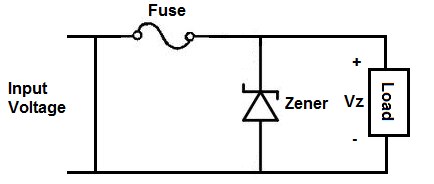

    shabaz over 11 years ago in reply to gadget.iom
    Hi Paul,
    You could use such an approach based on zeners as you say.
    I think just a text label could be "good enough" for RPI protection maybe (not everything needs an electronic solution), but a zener/fuse option may be cheap enough too (the zener
    needs to handle a high amount of current for a length of time, otherwise it could be damaged too - there are other tricks that use zener + MOSFET as an example).
    There are even dedicated ICs for this situation too - that's possibly a bit 'over the top' for protecting an RPI though.

    rew over 11 years ago in reply to gadget.iom
    Thing is: what are you prepared to handle... I have one of those 5.5/2.1 connectors lying on my desk here. It is connected to a 12V/30A ATX powersupply. That's some serious stuff to try to absorb that with a resettable fuse or a zener. And wasn't the idea to be able to provide more than say 100mA to the USB ports? So if you want "normal operation" at 4*500mA + RPI, your worst case becomes that the powersupply ends up delivering only 5.5V at 2.5A  (with the RPI+devices only using < 0.2A) (it's a lowsy 12V 2A or 2.5A powersupply), and you'll have to dissipate that heat in your zeners, at a current that the fuse should be able to tolerate....

    The kind of circuit I was thinking of employing is as follows:
    Would the Zener(s) have to dissipate any heat during normal operation in this configuration? There is a risk of zener damage when the reverse voltage is exceeded, though i'm wondering if the offset in cost of repairing/replacing this small board vs an RPi would make it an advantageous addition to the board.
    The resettable fuse could be rated at 2-2.5A. Following my (somewhat limited) experience with Zener barriers I may parallel two or three diodes to increase the infallibility factor. Might this also reduce the current each zener has to withstand?
