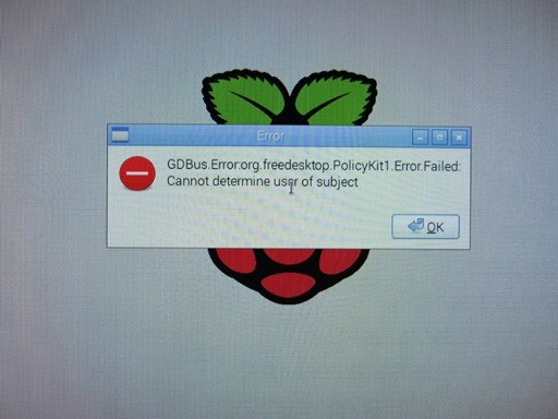

Today has received the Pi2 and was totally disappointed. Is very unstable. I do not even managed to set up the system. After a minute or two system is down. Then apparently fray fs continue after any issues downloading the same message "End Kernel panic - not syncing: VFS Unable to mount root fs on unknown-block(0,0)". That's all.image
    Actually you guys right - this is power supply issue. I tried next steps. Connect Pi2 to Li-Ion battery with USB. See pic. And all working perfect. No one faults over 2 hours. Ok. That is good. I made update and upgrade for apt-get. And further. Get short USB cable with ferrites and connect to another power supply. And whole day Pi2 works very good. No faults and much stable.
    Thanks everyone for advices and help!
