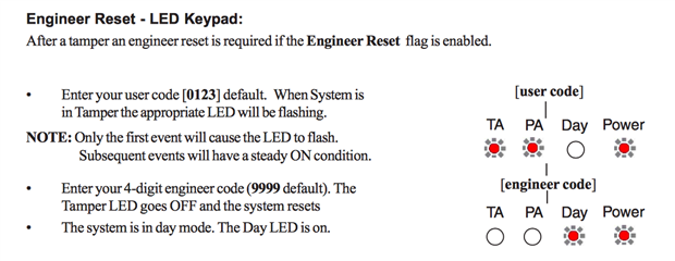

    Hi Shyam,
    Just bear in mind the alarm will probably go off when you take the panel off : ) A pain to deal with unless you're ready with the procedure to reset (will be in the manual, and if you remember the codes!).

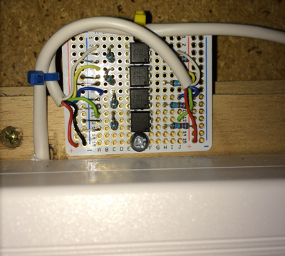

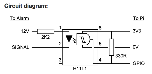

    Hi Guys,
    I had a few more questions before I attempted this.
    1. On the breadboard, do i connect the positive to the 13v terminal on the alarm panel?  and nothing to the 0v one?
    2. what pins do i connect the +/- to on the pi?
    3. while looking at the connections on this example : https://raw.githubusercontent.com/sidb/PiAlarm/master/breadboard.png
         2A connects to a GPIO Pin
         3A connects to a - on the breadboard
        4A connects to a + on the breadboard
        2C and 4C are linked by a 330R
        J3 connections to a connector on the alarm
        4I is linked to the + from the alarm via a 2k2
       My question is, how comes the connection to the alarm is on J3? and not J2?  Is it because the alarm connection needs to link with the -?
    Could I use a tester to see what the output is on the PI side before connecting the PI to it?
    Thanks
    Shyam

    gadget.iom over 11 years ago in reply to e14 Contributor
    1) 13V to red wire '+'
    2)  - to GND, + to 3.3v
    3) J2 is connected to pin 3 (an unconnected pin) on the opto-isolator.
    As shown on this diagram from the github page:
  • gadget.iom
