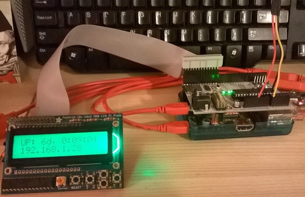

Hi All,
I have trying to track down a bug, either in my code, or with my Pi B or possibly a Adafruit RGB LCD Plate. Initially I thought the problem may have been with the Pi's thermal sensor as it had appeared from research that there was such a problem in the past.
However, I've run about a half dozen experiments to isolate the problem and it appears that any time I am outputting to the Adafruit LCD and reading the internal thermal sensor, the python script will freeze randomly over a couple of days of running.
The setup is basically, a Pi Model B, a Wyolum Alamode and the LCD Plate stacked on top with a ribbon cable.
The significant code in the python script is...
with open("/sys/class/thermal/thermal_zone0/temp","r") as file:
        value= float(file.readline().strip("\n"))
It always freeze either at the open or the read.
I also have a temperature sensor connected to the Alamode. If I read from the internal temp sensor and utilize the LCD (for example, to display the temperature), I get the random freeze. When I use the Alamode's sensor and the LCD, it runs no problem. I have also removed the LCD and read the internal sensor and... it runs no problem. So I'm kind of getting the impression the Adafruit LCD might be the problem. I am going to take this up with them at some point... but a final note, the LCD uses I2C for communications and I am reading from the Alamode over serial.
However, all that being said, has anyone else experience a similar problem or conflict while reading from the internal CPU temperature sensor... or have any ideas what might be the problem???

  • ejohnfel
    ejohnfel over 11 years ago in reply to clem57
    Hi Clem,
    Thanks for the response. The two references you gave, I know them well already. I am pretty sure the LCD and Alamode are not interfering with each other since, when I use them without reading the CPU temp sensor, I get absolutely no problems. But as a just in case, I am running another experiment without the Alamode just to be sure.
    Please see the included picture. I basically extended the LCD out from the Alamode using and extra long Pi header and extension cable (both from Adafruit). In the photo, you can see the TMP36 sensor sticking out of the Alamode to the right. The Alamode, actually, mainly the AVR chip's function is to make sure the Pi and other hardware its driving, do not overheat and should that happen, will power the whole thing down until it cools off.
    Also, I have a similar setup already working. The basic difference is that there is no Alamode and instead of one controlling Python script I have two Python scripts and a few shell scripts that run independently to each other (ie. A shell script reads the temp sensor (and various other things) along with another python script to collect a little more data, then calls the final python script to display that data on the LCD.
    At this point, I suspect, its the Adafruit library code. Mainly because, the working project is using a much older version of the Adafruit code. The project in the picture (the replacement for the old one) uses a much newer version. I do know the script freezes while reading the internal temp sensor because of debugging code I have around the read and that flushes I/O on every write shows it does not complete.

  • rew
    rew over 11 years ago in reply to ejohnfel
    The I2C hardware module in the raspberry pi is buggy. It claims to support clock stretching, but gets it wrong. The I2C spec requires a "clock high" of 5 microseconds when running with a 100kHz clock. But when the slave stretches the clock for 4.9, 9.9 or 14.9 microseconds, the broadcom will look at the clock (at 5, 10, or 15 microseconds) and see: Hey: it's high, so I can continue with the next LOW cycle. This results in a clock of only 0.1 microseconds, with "funny" results. Broadcom has known about this bug in the 2835, and apparently decided not to fix it for the BCM2836.
    When I see this bug, it leaves the bus in an invalid situation after one transaction, but after mangling the next i2c-tranaction, it recovers and the i2c-bus starts to work again.
  • ejohnfel
    ejohnfel over 11 years ago in reply to rew
    Ok, now that is a golden nugget of info right there... I don't know if that's the problem, certainly seems it could be. Thanks Roger. It gives me an excellent place to focus my attention.

    ejohnfel over 10 years ago
    In case anyone was interested.... I know this is a bit late... I never solved the problem. I eventually went to the RPi foundation's forums to get help. I was very quickly slapped down; no one could reproduce the problem.
    There was one other person who was experiencing the same problem though.
    So the effort to figure out what was wrong went no where.
    However, some time later, apparently the bug reared its ugly head... it seems during the Sense HAT development and the AstroPi project it was discovered.
    So the RPi foundation finally acknowledged there was a problem and fixed it.
    The other person having the problem notified me that they had fixed it. I immediately downloaded the latest Raspbian and I can say for certain, the problem has been fixed. The original project that exhibited this bug, now works flawlessly.
