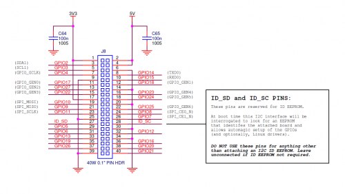

Hello all, I have no clue what I am doing when it comes to using a breadboard and raspberry pi. I found a DIY for reptile enclosure that I am building it is located here: http://www.raspiviv.com/raspberry-pi-vivarium-controller/fans
I am comforable with the code etc, but unsure what to do with the breadboard. I need 2 5V computer fans hooked up to the breadboard which will be automatically activated when humidity hits a certain level. I understand that this is laid out but the examples are chinese to me. Any advice on how to see exactly how the wiring needs to be besides what has been provided? Thanks in advance!

    The instructions are OK if you know what you are doing. Have a look at Dimitrios' first picture. All of the holes with a red or a blue line by them are connected together vertically as a power bus bar. The author has connected the +5Volt GPIO Pin 2 to one of the +ve (red) bus bars using a jumper lead. The positive lead from the mini blowers is plugged into a spare position on this bus bar. He has not connected the 0Volt Ground Pin 6 to the -ve (blue) bus bar and has chosen to connect it to one of the 5-pin buses described in the next paragraph.
    The breadboard has two halves and each half has a +ve and a -ve bus bar. Each of the five horizontal holes in a row are connected together. The author has connected a jumper lead from GPIO Pins 18 and 22 to two of these 5-pin buses (but you can only see one of them). A 10KΩ resistor is also plugged into each 5 pin bus. The other end is plugged into another horizontal bus and the base connection of the transistor is plugged into the same bus. The transistor collectors are plugged into the adjacent bus which is also connected to the 0V or Ground GPIO Pin 6. The transistor emitters are connected to a third 5-pin bus and so is the negative lead from the mini blower.
    The Raspi sends a low current, +3.3V signal on GPIO Pin 18 or 22 via the 10k resistor to the base of the relevant transistor. This tiny current and voltage is enough to make the transistor conduct from emitter to collector, but not enough to overload the Raspi GPIO pins. Power flows from the Raspi +5V supply at GPIO pin 2 to the +ve of the blower, through the blower to the negative lead and on to the emitter of the transistor. It flows through the transistor to the collector and thence to Ground.
    The Raspi is providing all the 5 Volt power to the mini-blowers. You must make sure to use blowers that only use modest power as anything more will either 'blow' the Pi fuses or lock up the Raspi because of too much voltage drop down the Pi's USB power lead.
    You need to be careful with the GPIO pin numbers. The diagram does not show a complete GPIO header. These should help you out. Pin 1 is marked on the Raspi PCB.imageimage
