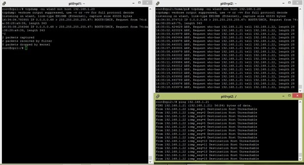

Hallo
Ich versuche ein Ad-hoc Meshnetz mittels 4 Raspberry Pi's Model B aufzubauen. Hier sind die Hardware Eigenschaften:
  • 4x Raspberry Pi Model B ( Raspbian Debian Wheezy 3.18)
  • 4x Edimax EW-7811Un USB WiFi Adapter (RTL8188cus)
  • 1x Laptop mit Win 8.1 um auf die RPi's über SSH (PuTTY) zuzugreifen
ich habe die RPi Netzwerkeinstellungen wie folgend konfiguriert:

Das Problem ist, dass ich von einem RPi zum anderen nicht direkt pingen kann.
pi@rpi1 ~ $ ping 192.168.1.22
PING 192.168.1.22 (192.168.1.22) 56(84) bytes of data.
From 192.168.1.21 icmp_seq=1 Destination Host Unreachable
From 192.168.1.21 icmp_seq=2 Destination Host Unreachable
From 192.168.1.21 icmp_seq=3 Destination Host Unreachable
From 192.168.1.21 icmp_seq=4 Destination Host Unreachable
From 192.168.1.21 icmp_seq=5 Destination Host Unreachable
From 192.168.1.21 icmp_seq=6 Destination Host Unreachable
^C
--- 192.168.1.22 ping statistics ---
7 packets transmitted, 0 received, +6 errors, 100% packet loss, time 6004ms
pipe 3
Hat jemand vielleicht eine Idee wie ich die RPi's mit einander zu kommunizieren bringen könnte? vielen dank im voraus

    If the raspberry pi ".21" says that ".22" is unreachable (your last ping listing) then it doesn't have the route to that raspberry pi.
    Your route should look something like this:
    # route -n
    Destination     Gateway         Genmask         Flags Metric Ref    Use Iface
    192.168.1.0   0.0.0.0         255.255.255.0   U     0      0        0 wlan0
    Somehow, it seems as if this is missing.

    So, when "pi1" has a packet for "pi2" it knows it should issue an "arp" broadcast on wlan0 asking for the MAC address of (the IP address of) pi2. Pi2 should answer, and then the packets for pi2 should be sent on "wlan0" directed at the proper MAC address.
    Next step would be to monitor "wlan0" on both pi1 and pi2 to see what's going on. Install tcpdump and issue: "sudo tcpdump -ni wlan0" in a separate console window on each pi. Make sure the output does not need to go over the wlan. Or if you're logged in over SSH from the laptop you could exclude traffic to and from the laptop by adding "not host laptop" (substituting the right IP for the laptop).

    Ping from Pi2 --> Pi1
    root@rpi2:/# ping 192.168.1.21
    root@rpi1:/# tcpdump -i wlan0 not host 192.168.1.20
    tcpdump: verbose output suppressed, use -v or -vv for full protocol decode
    listening on wlan0, link-type EN10MB (Ethernet), capture size 65535 bytes
    15:39:05.201599 IP 0.0.0.0.bootpc > 255.255.255.255.bootps: BOOTP/DHCP, Request from 74:da:38:28:a9:39 (oui Unknown), length 343
    15:39:05.310423 IP rpi1.local.mdns > 224.0.0.251.mdns: 0 PTR (QM)? 0.0.0.0.in-addr.arpa. (38)
    15:39:06.311936 IP rpi1.local.mdns > 224.0.0.251.mdns: 0 PTR (QM)? 0.0.0.0.in-addr.arpa. (38)
    15:39:08.312679 IP rpi1.local.mdns > 224.0.0.251.mdns: 0 PTR (QM)? 0.0.0.0.in-addr.arpa. (38)
    15:39:10.314170 IP rpi1.local.mdns > 224.0.0.251.mdns: 0 PTR (QM)? 255.255.255.255.in-addr.arpa. (46)
    15:39:11.315891 IP rpi1.local.mdns > 224.0.0.251.mdns: 0 PTR (QM)? 255.255.255.255.in-addr.arpa. (46)
    15:39:13.317622 IP rpi1.local.mdns > 224.0.0.251.mdns: 0 PTR (QM)? 255.255.255.255.in-addr.arpa. (46)
    15:39:15.323472 IP rpi1.local.mdns > 224.0.0.251.mdns: 0 PTR (QM)? 251.0.0.224.in-addr.arpa. (42)
    15:39:16.325150 IP rpi1.local.mdns > 224.0.0.251.mdns: 0 PTR (QM)? 251.0.0.224.in-addr.arpa. (42)
    15:39:18.327283 IP rpi1.local.mdns > 224.0.0.251.mdns: 0 PTR (QM)? 251.0.0.224.in-addr.arpa. (42)
    15:40:10.089396 IP 0.0.0.0.bootpc > 255.255.255.255.bootps: BOOTP/DHCP, Request from 74:da:38:28:a9:39 (oui Unknown), length 343
    15:41:14.490669 IP 0.0.0.0.bootpc > 255.255.255.255.bootps: BOOTP/DHCP, Request from 74:da:38:28:a9:39 (oui Unknown), length 343
    at Line 15. it stopped for about 3 Minutes ....

    If pi2 is still pinging and saying " no route to host" then you are very unlikely to see anything happening on pi1. So what is the tcpdump on pi2? (/while/ it is ping-ing).
    Wait... Someone on your network is doing DHCP. Ifconfig on most machines will show you the mac address. Who'se mac address is 74:da:....
    Also, you seem to have left out the '-n" option on TCPDUMP. If you leave it out, tcpdump will try to resolve all IP addresses to names, and that often causes more traffic and delays while the lookup is happening. So often with these "basic networking" problems you don't want the convenience of the lookups.

    What you should have mentioned is that the "host unreachable" messages come three at a time. This is a clear indication that the computer is doing ARP, but not getting a response.
    The ARP broadcasts from pi1 are not reaching pi2 (or the other way around). I would have expected this to work.
    The remaining problem is that your packets from pi1 are not reaching pi2. This is a wlan problem above my paygrade. :-) I'm good at TCPIP, but not so much at WLAN. Sorry.

    I tried to add the MAC address of Pi2 in arp of Pi1 and the other way , and it worked ! now I can ping from Pi ot Pi, but I still can't understand the reason why the Pi can't find each other automatically.
    anyone hardware experts out there?  image

    This would mean that the BROADCAST arp does not work, while a directed packet does work. What ethernet addresses do you see on the ARP packets in the tcpdump if you add the "-e" option on the commandline?

    I recall that wireless 2.4Ghz topology has something known as a hidden node effect. A radio can reach radios in the area but not some that are located farther away. But a central node can reach all. If two nodes are close to a central node but too far from each other can have this happen. Walls and other things can exasperate the issue.

    Yes Clem, but in this case the nodes can reach each other, but only the "broadcast" packets from one pi are not reaching the others. As if the wifi sticks are ignoring (some) broadcast packets.
